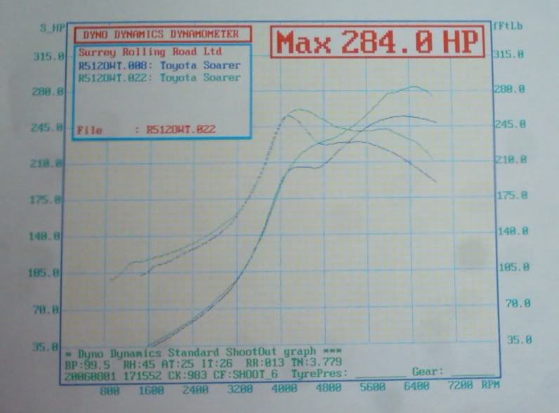

Heres my info
This graph is stock versus blitz bag tubbies before & after cross referenced, both running 1 Bar of boost, stock everything including air filter!

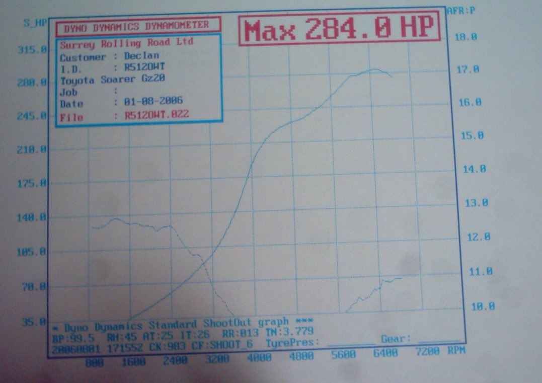

And heres my AFR's on the Blitz tubbies again stock system
Last dyno pull at 1.4 bar made 320bhp on the Bag tubbies
