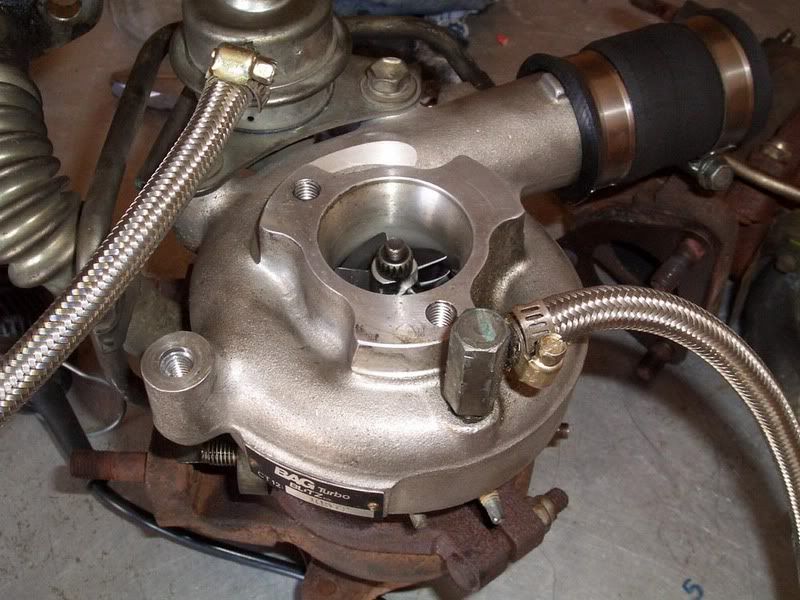

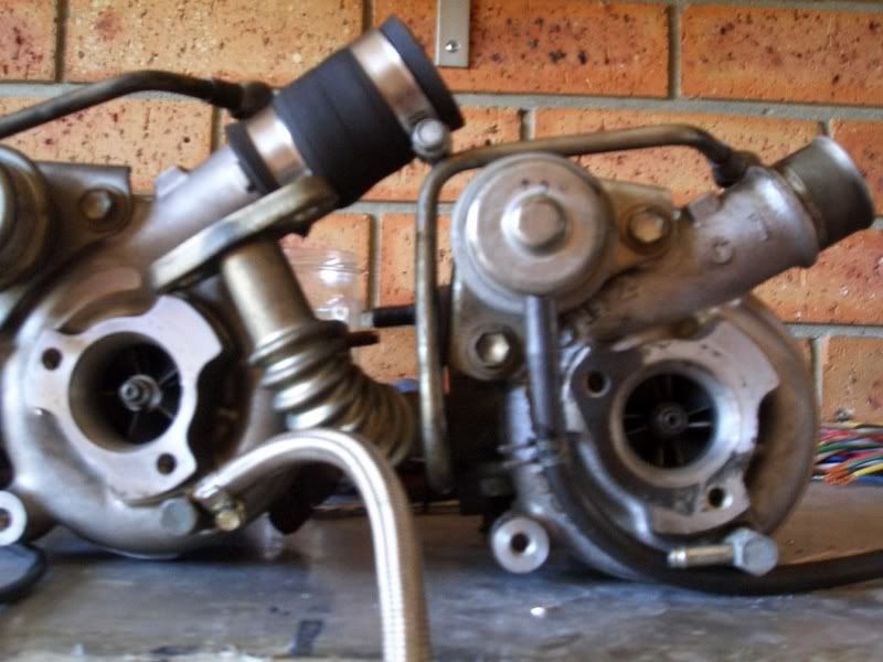

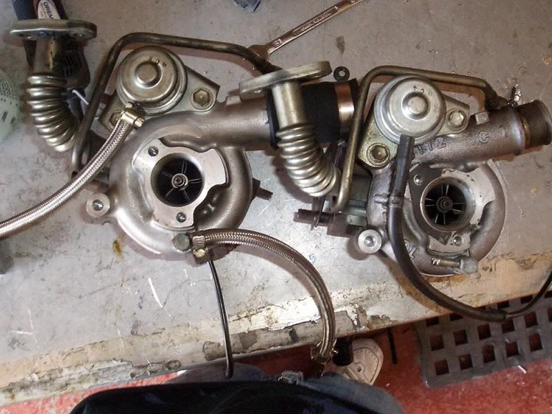

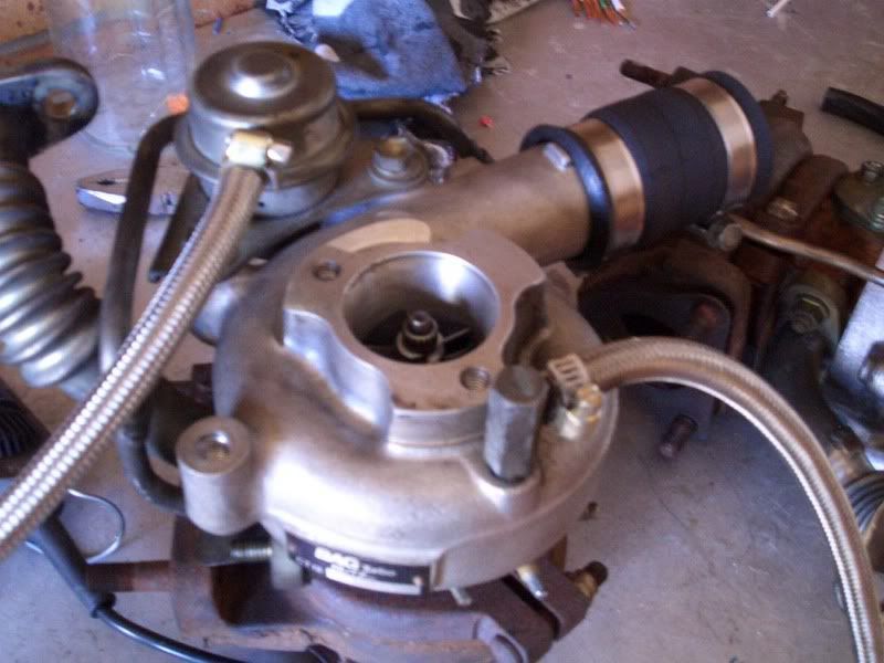

    Well I just pulled out my turbos today and re-read this tread. There are significant differences between the stock turbos and the blitz. For starters the Blitz turbos are physically bigger. They also have a different impeller design. Here is some more info from a blitz catalogue.
    "The impeller diameter (core component of this bag turbo) is enlarged by 17%, and its precision balance is improved 10 times. The compressor housing is made of new material and specially heat treated to improve durability by 44%"
    Anyway’s picture tells a thousand words so here are some pics. The dirtier turbo is the stick gen 3 ct12.
