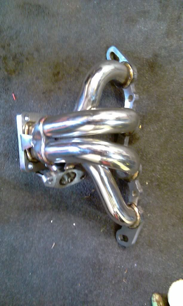

    This may help to ???
    this is a manifold for my turbo and it fits both 16v and 20v heads... note the to end holes are slotted !!!
    16v users the top part of the hole !!!! and 20v users the bottom!!
    Good luck!!!!
