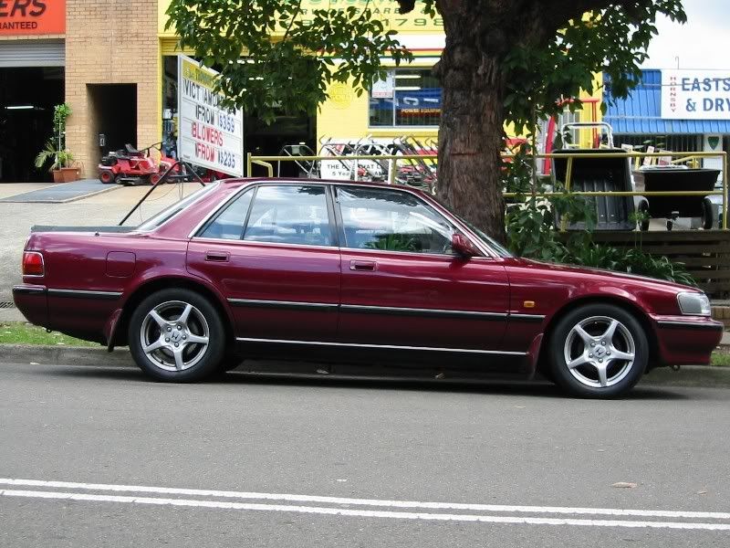

    MRZ your back still looks too high, are you using mx83 shocks or ma70 shocks?
    220 for 4 kings springs thats a good deal!

    I'm using MA70. Yeah the rear is still a bit high but lower than stock.
    Yup I paid $220 for 4 springs.

    Handling wise, wayyyyy better than stock. It is a good setup for a daily car. Big thanks to you for letting us know about using the MA70 rear and Rav4 fronts. It is a good replacement for the stock ones.
    And a new pic of the car taken today still waiting for ride height to settle.

    Just get a whiteline rear sway bar now. Don't botther with the front one.
  9. #54
    5,543
    Default Re: MX83 Lowering Options
    Yeah, rear swaybar is really all they need.
    P.s. nice honduhhhh wheelcaps.

    im thinking now some ma70 coilovers in the back and the rav 4 doobies in the front.
    all the cressies i have seen with ma70 shocks and king lows still look too high in the back for my liking.

    Quote Originally Posted by MRZ
    Hi Andrew
    youre just round the corner from my shop!
    think ive seen this car a few times also.
