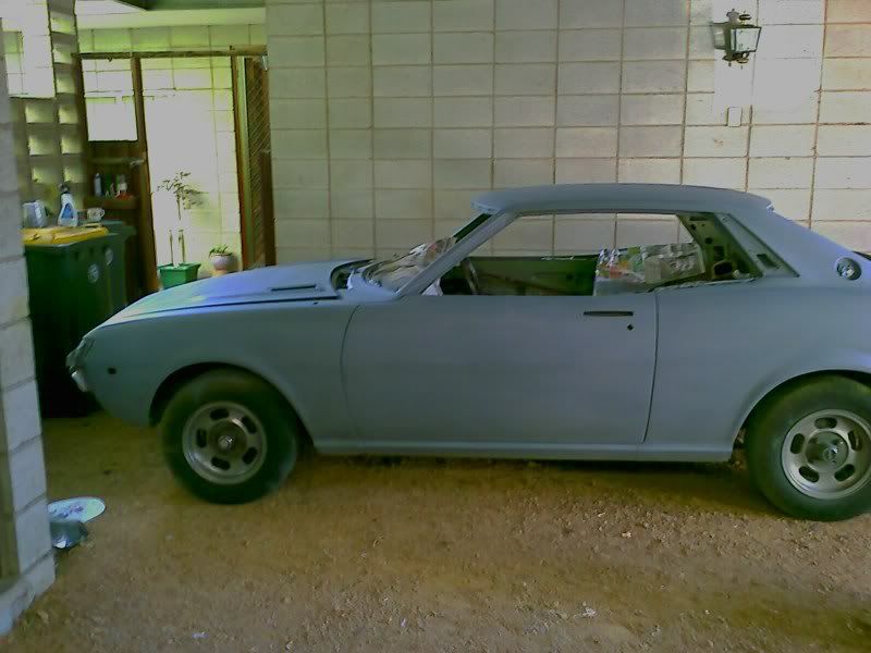

    As requested, here you are guys

    A bit of a hint that I got told against my reasoning... mask up the window holes when painting, as the paint particles from overspray will cavitate around inside the car and become dust which will settle on the wet paint.

    Quote Originally Posted by Neverland
    just another quick tip before you paint
    if you have a leaf blower , blow away dust and stuff from around the carport that is if thats the area that you are painting in
    then wet the floor , this keeps any dust down
    and finaly EARTH your car to a water tap , or car port metal staunchion , this will help in keeping the static electricity down , and as we all know from our science class , static attracts dust
    thats the lesson today kids lol

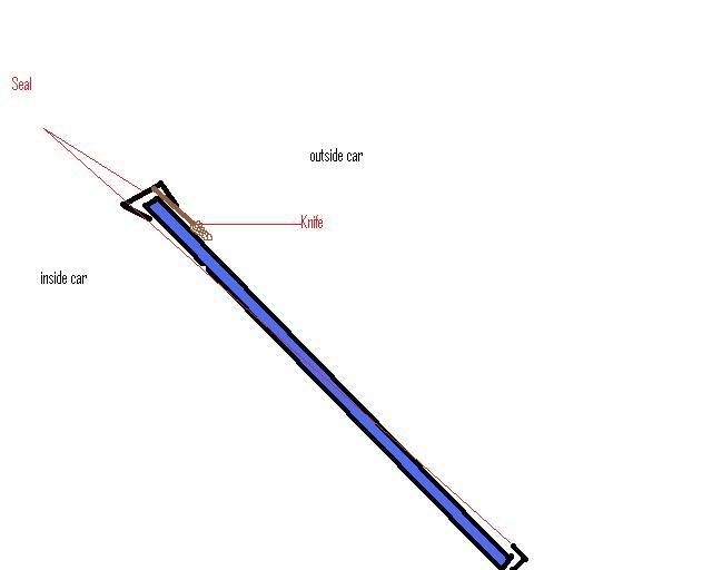

    What technique did you guys use to get your windscreen/rear glass out??

    Hey Jarrod,
    For both windscreens I used a sharp knife to cut away the outside of the seal( it was a bitch because it was VERY old and hard, non flexible.)I slide the knife in parallel using the screen a 'guide, making sure i kept it as flat as I could against it and 'shimmied' it along. Kinda like filleting a fish. If you have an angle, its very possible to to crack/shatter the glass if the knife catches on the edge.
    Sometimes it got a bit stuck due to the black gooy stuff, so I used little squirts of WD40 to lube it up to make it slide. Also be very careful that knife doesn't slip, if pulling towards you, becuase the force of pushing the knife into the seal and pulling at the same time, if it had slipped the force would cause the blade to cut/slash/gash you...
    After you hacve cut all the surrounding flap off. carefully using equal amounts of pressure to push up the screen.If possible have someone else there to guide you and tell you if the screen looks like its flexing too much. Once you're sure the screen is loose using gloves of course tilt the screen up and with, if possible a mate to lift it clear from the car.
    The hard part over now remove all the metal clip by sliding them up from the notches and pull /rip the remainding rubber seal off
    Good luck, its not as hard as it seems, just tedious ,remebering not to angle the knife
    any more qs please dont hesitate to ask
    Dave
