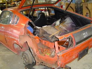

    OK, that last lot of photos made me sad in the pants

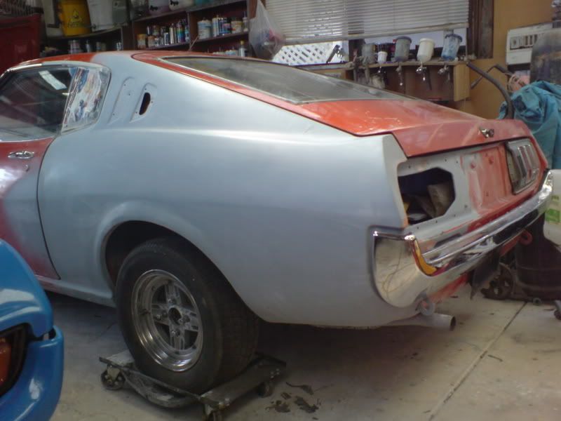

    i little heat and a bit of bog sculptre and no one will know

    Quote Originally Posted by ian
    i little heat and a bit of bog sculpture and no one will know
    I hope so...
    Its much worse than it looks in the photo above.
    Its going to take a lot of work.

    hey mwp was yours as bad as this
    ian
  6. #141
    6,684
    Nice work Ian... gives me hope!! (mine has a similar ding to MWP's)
    hey mwp was yours as bad as this...
    Well it could be underneath the rest of the panel... but im not going that far.
    It has good shape, so im just going to leave the current filler on it.
