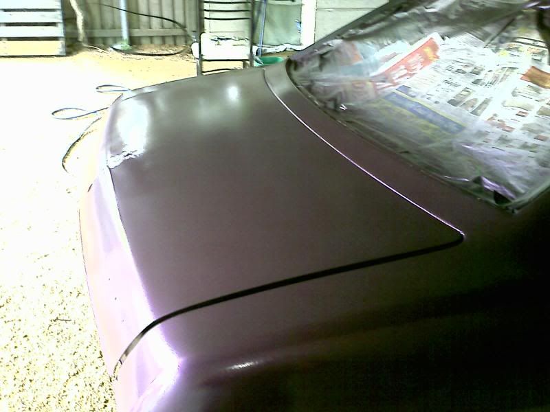

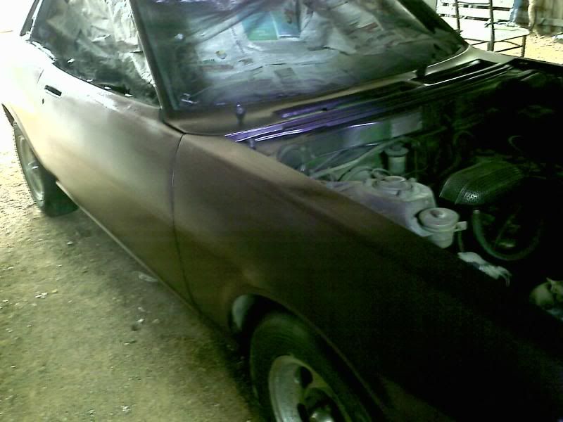

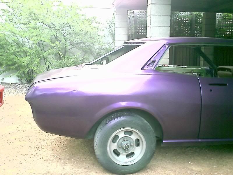

    HI guys here an update
    Got the Arvo off and went to pick up the paints. Got home and thought to myself I'll just do the door jams.......well this is what I ended up doing doh
    I also ended up doing the clear aswell.... Looks like I'll be Buffing on the weekend.
    Silly me

    I'll get some better ones when the sun comes out to play
  5. #185
    4,565
    Looks like a lot of orange peel in that first photo.
    Its going to take a lot of buffing if its like that all over

    Yeah there are a few spots so do you reckon I wet 'n dry and then clear coat again?
  8. #188
    Eltham vic
    1,584
    hi neverland
    let it dry for a few days then with a hard rubber block and some 800# with soapy water block it back flat and with a softer fexible rubbing block for the high spots
    it will make buffing it back a lot easier you can also give it another coat of clear, if it blocks back nice and flat , make the top coat of clear a bit thinner , this makes it flow a lot better , careful not to get runs with the thinner mix

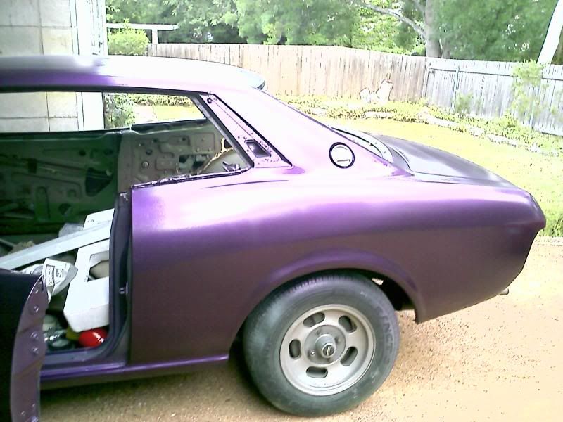

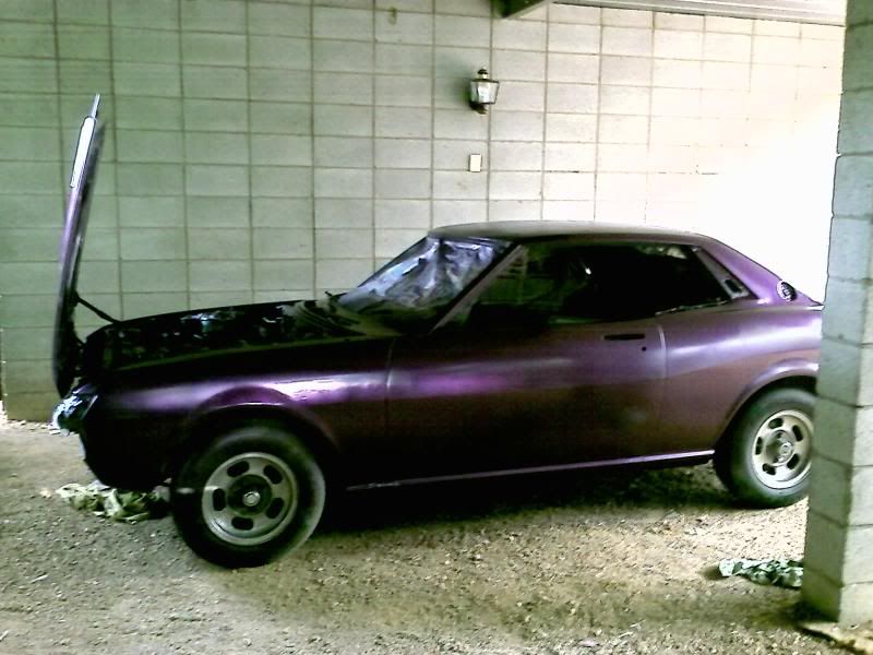

  11. #191
    8,214
    My effort for the previous weekend.
    About 4 coats of primer, followed by about 6 coats of Toyota Supra Red (3D1) (with sanding and bogging in between).
    Doesn't look like a perfect match at the moment (not too happy about that), but we'll see what happens after a polish.
    Using a bottle feed (vacuum?) gun, cost about $150odd, and a cheap Marlows teeny compressor. Gun pressure was about 55-60psi. (gun box recommends 45-70psi, paint recommends 40-60psi).
    Primer went on pretty nasty as the vent hole in the gun was blocked and I didn't know
    Peewee
