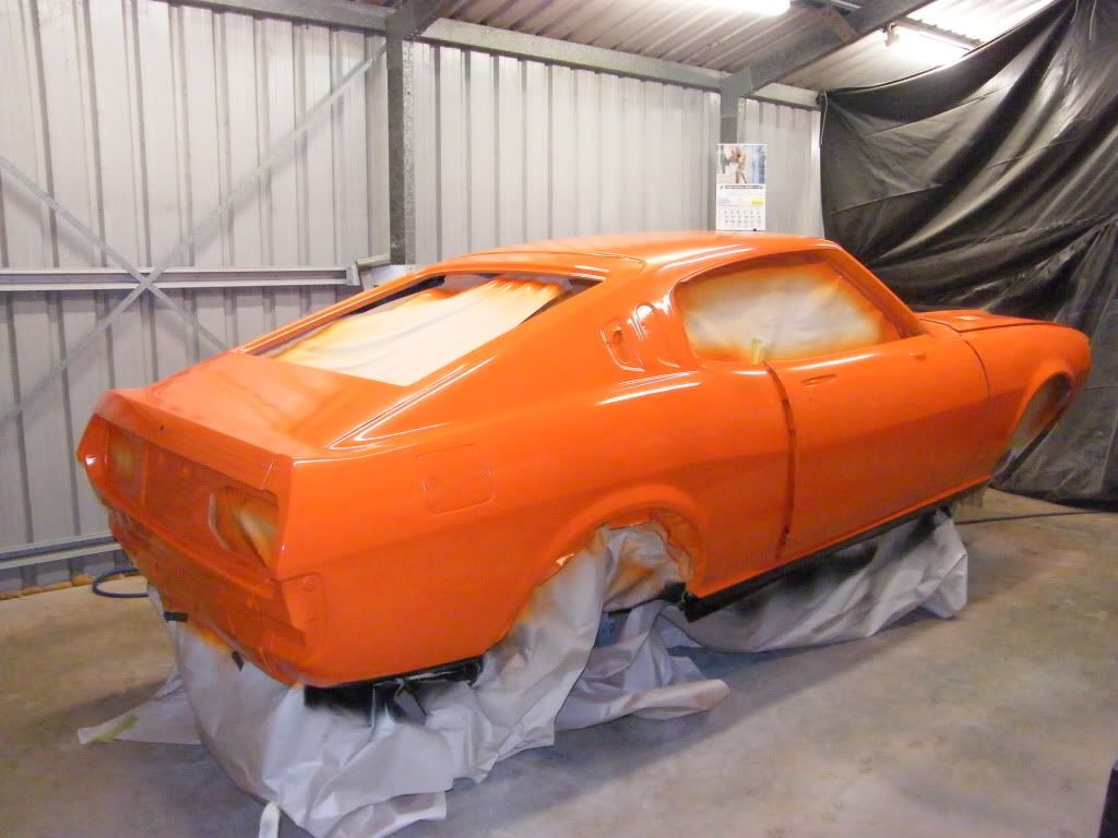

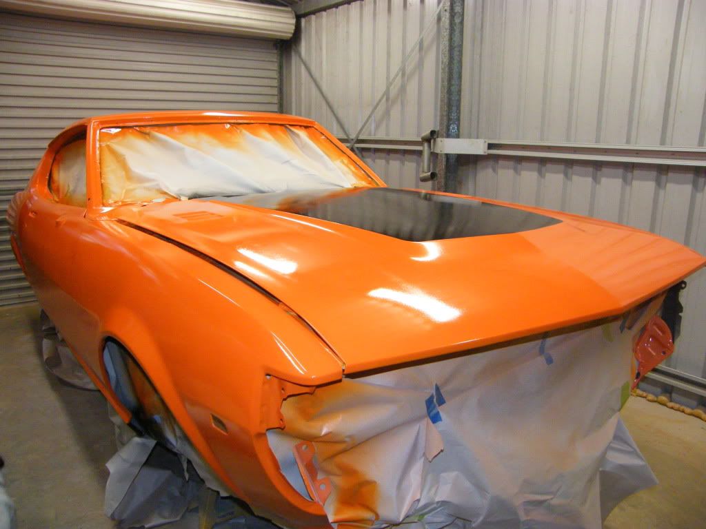

    We finally had good weather for a change (the fact it didn't rain for Easter is a miracle in itself, let alone having 2 good weeks after about 18 months of rain). It decided to break that spell last night, however I did manage the following on Sunday (started spraying about 11am after a massif yo sand-a-thon) and packed up the last of the gear about 11pm.

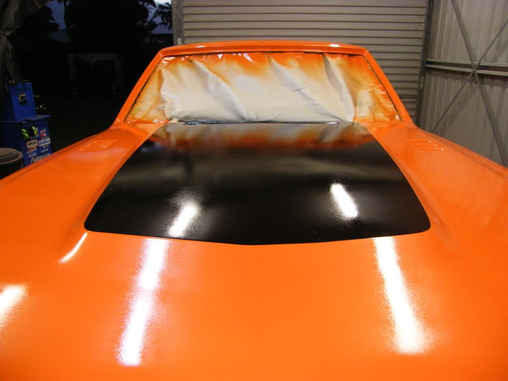

    I think I had the pressure too high on the clear, as it is extremely mottly and there was a lot more overspray that I would expect from an LVLP gun. I'll play with that after I wet sand and get ready for the second coat of clear. There are also a couple of really nasty spots where the paint got savaged by a very tired hombre with perhaps a bit of excessive inexperience. I'll sand these flat and touch them with colour before the second coat of clear.
    Overall, the job is good from afar, but thus far, far from good.
    The colours were really good right up to the last moment before clear. There is a spot in the orange on one of the rear qtrs where my pants rubbed on it as I was doing the roof, I'll block it flat and touch it up (unless of course doing so will kill me with a fry up?? Thoughts?? I would have thought with the paint being only a few days old, it should go on without fry up.
    Your paint will fry unless you leave it for a few weeks min... The sooner, the worse!
    With the "mottly" looking clear (looks like orange peel in the pics IMO), it looks like a couple of things from the pics. Could be that the clear needed a little more thinners in the mix (remember the mix specs from the paint co. are just a guide). Also looks as though you could have benefitted from a slightly higher flow, you might have been wary of runs.

    Was the paint all acrylic? if so fry up should not be a problem. However if the clearcoat is 2pak. ie COB, then any attempt to re apply colour over a feathered edge will turn into a monumental headf#@%.
    Overall you got a fairly uniform coat of colour and clear, just add some more thinners to the clear. If it is acrylic, you can use 10% clear and 90% thinners for the final coat. If you have more than one coat of clear on there, I would simply suggest you colour sand it and buff it rather than adding another layer of clear.

    It is a COB system. The manu specs had and indication of up to 10% thinning, I went to that 10%. It was also a fairly cool evening, so too much temperature wasn't an issue. The mottly look is far worse than orange peel in some areas. You may be onto something about not putting enough flow in (though I do think I had the pressure about 5psi too high)
    I really would like to be able to block back 3 spots and re-apply some colour to get a decent result on those eyesores (they really do make the whole job look like shit as is - there are several other minor imperfections due to bugs etc that I am not really worried about and won't bother fixing). If I can't then I will look at stickers to fix up the issues. Simon, if I let it sit for 3 weeks, then feather back and re-apply colour using multiple ultra light coats, would this prevent fry up??

    This statement yielded me the theorum that resulted in success. It is the clear that causes the problem with respray, something I didn't know before, and would have massifly helped me prior to spraying (would have cut the clear back on all edges, have fry up in some places where engine bay, door jambs etc meet with the rest of the job). I blocked back the 3 main problem areas until all clear was gone, and using a very small flow and a fine fan, I sprayed ever so light coats ensuring that I didn't get too close to the feathered edges.
    Although I now have a dark patch in the orange, and there are two spots on the black which will net a semi-visible blemish, the overall result is that the faults in the paintwork won't be noticeable until you are closer than 5 metres from the car. I'm pleased enough with the correction. I also fixed up the worst of the fry ups, but have decided to leave the others be as I would probably cock them up to a worse state than they currently are in. So all is looking good to pop the second coat of clear on maybe Friday night (nice thin coat), and drop the third on Saturday morning. If I have paint leftover, I'll do a fourth. I'll need more clear for trim pieces, but it is easy enough to purchase in a small kit for that purpose.

    Hmm... may be re-thinking that re-clearing. The colour repairs came up great, blended well and just look like minor recesses where I sanded too much in one spot. Put clear on, and the feathered area seemed partially ok, but where I had just prepped and painted without sanding fried up like a mofo. Supposedly should be able to put this clear over itself with only a clean up not sanding within the first 7 days... unless of course it means I have to clean it with a special fluid and not just wax/grease remover??
    What would be my best option?? Clear is sandable/reworkable after 24 hours, and fully cures in 7 days. Should I leave it 3 weeks, sand and re-clear?? It does need re-clearing, it is waaay too thin to think about leaving it.

    Owen, I would leave it for the 7 to 10 days, then give it a sand down with 800 wet, then recoat with the clear. If you are having to paint late in the evening, consider using a different hardner. ie a fast hardner will set up quicker and begin curing faster.
    The trick here is to try different amounts of each hardner. Lets say you subtract 10% to 20% of the normal hardner and add 10% to 20% fast hardner.
    You will also find that if you add another 5-10% reducer, you will improve the flow from the gun, improve flow out/levelling of the paint, and your gloss level will improve as well. Believe me you will be stunned at the lack of sanding required if you use my mixing ratio's.
    That 10% reducer as stated by your paint manufacturer is only a starting point, you can and should adjust for your individual conditions from there.
