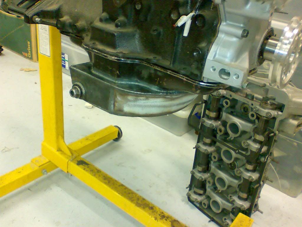

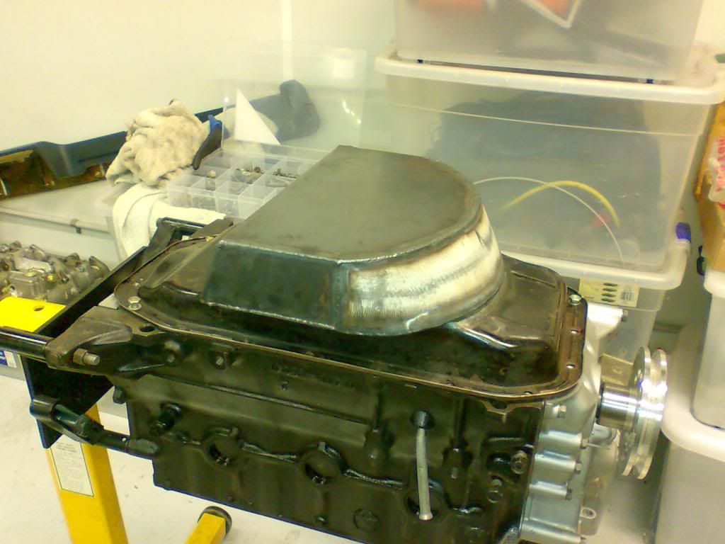

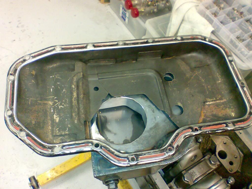

    This is my 18rg mid sump, works well, still needs an extra litre to stop any fluctuations in oil pressure. I use 30W50 full synthetic
    Rgds, Willofan
