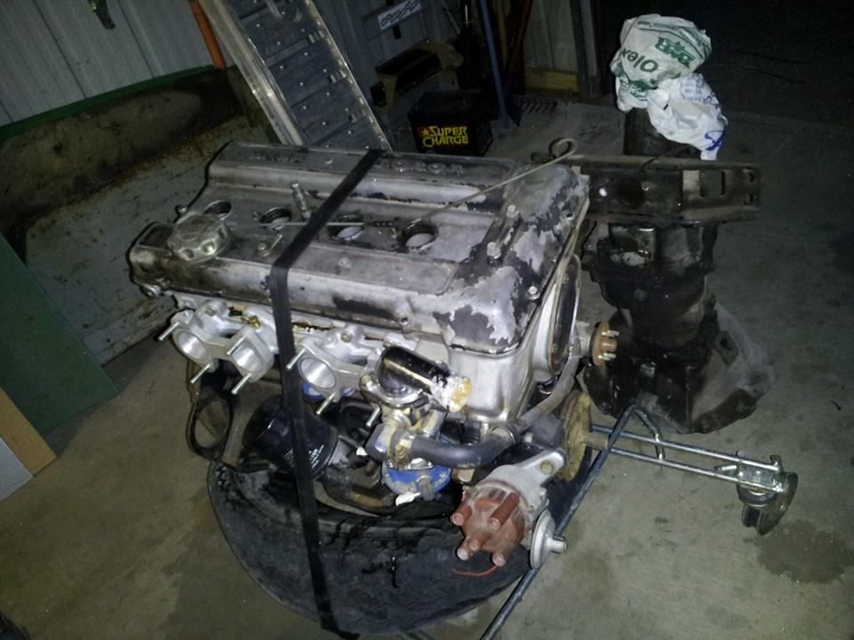

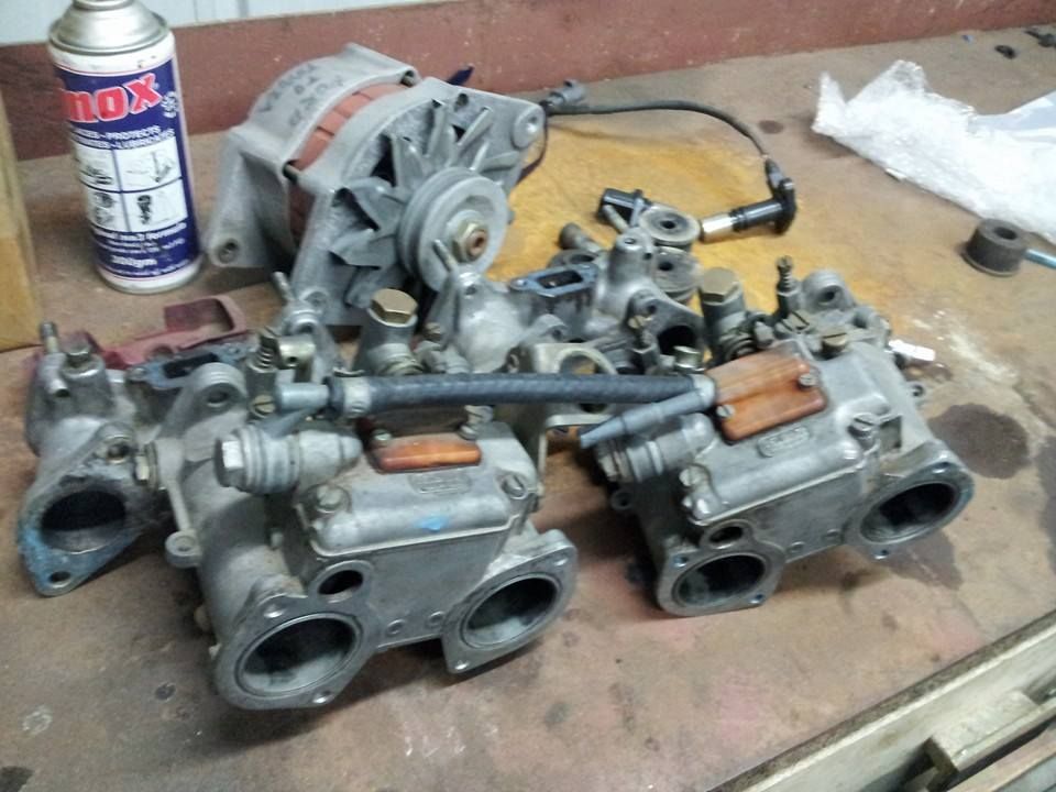

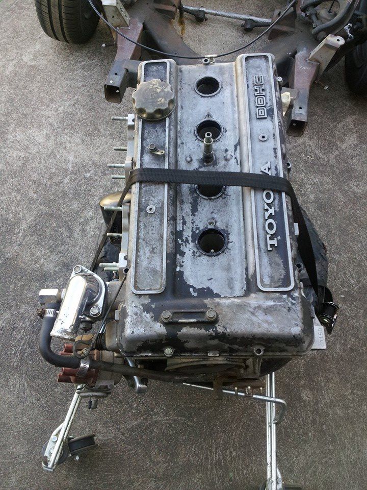

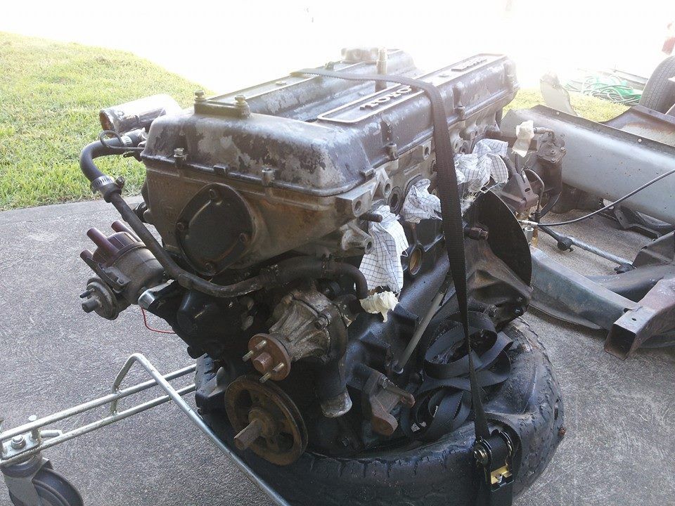

    So I got a tractor for the Stout. You guys twisted my arm. Haha
    88253 Head with standard cam
    Came with Dellorto DHLA 40's and manifold
    Spare webber 45mm ported manifold.
    Pace maker extractors
    There will be a few things I need to get for it.
    Throw out lever, slave cylinder and shifter for the box.
    Has a Falcon alternator, is there a bracket assembly for that I do I need to fabricate one?
    Also a kit to convert the points distributor to electric. I'm lead to believe the instructions are on here somewhere?
    I've been looking at camtech site for a re-grind, I'm after a profile that would suit it, since the Stout is a truck, it will have to behave like one. (Torque Low/Mid range power). Any suggested cam profiles?
    I don't want to loose that Lumpy idle!
    http://www.camtechcams.com.au/toy_4cyl_2tg3tg18rg.html
