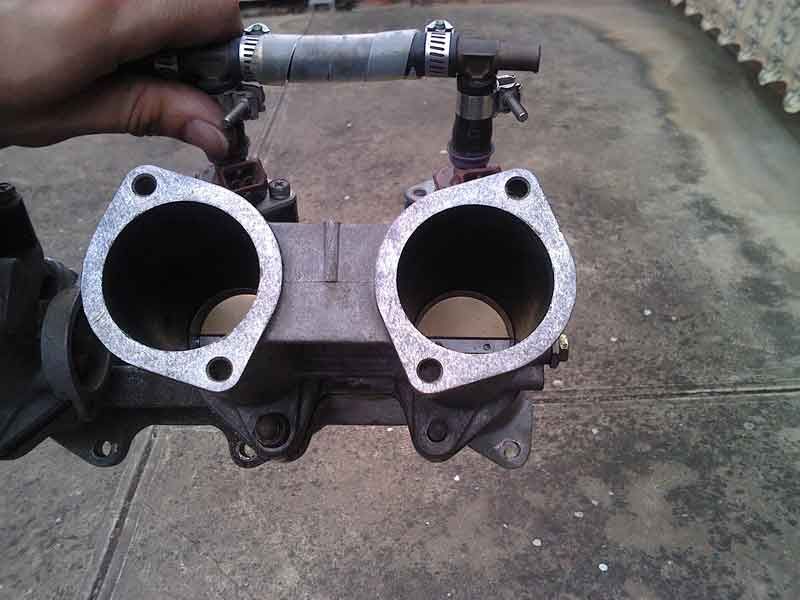

Just wondering what peoples experience has been with the DCOE style ITBs
such as:
http://www.jenvey.co.uk/home/twin-th...oe-style-tb45i
http://www.injectionperfection.com.a...nt/view/21/71/
http://www.efihardware.com/products/...hrottle-bodies
http://www.borla.com/products/induct...leBody-FR.html
They seem like a very cool item. Would having the injector further from the port cause any drama?

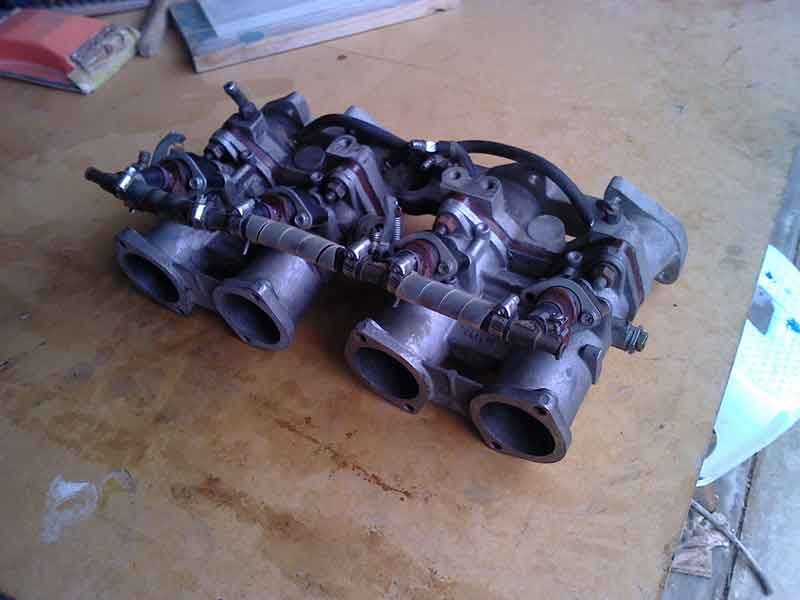

I've got a set of old HKS 40mm DCOE throttles on a big bore manifold, but haven't set them up on an engine yet.
They use mikuni phh shafts, butterfly valves and seals so I can get replacement easily enough.
I'm thinking of having them bored out to 44mm using the Mukuni 44mm parts.

Yeah man, efi hardware pro - race 45-48mm tapered throttle bodies. (Didnt buy it as a kit though, bought the tb's second hand, everything else i bought new from an efihardware distributor in WA)
