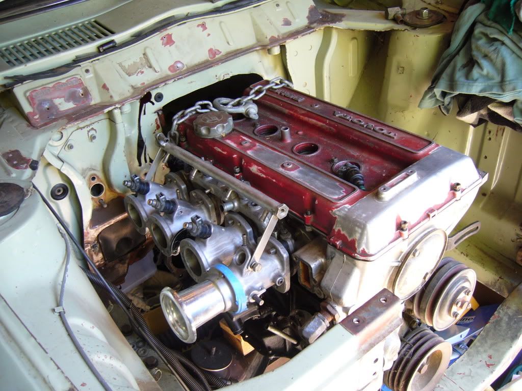

    Just picked up a set of ITBs for my big block 18RG I guess i'm leaning a little more towards retro tech for the KE10 now
    and pics of said ITB's
    The long ram tubes they come look look like they'll fit no probs....remote brake booster will be needed but that was on the cards anyway.

    466
    They look awesome Justen. What is the compression ratio of that 2.4L monster?
    RA28 Turbo 18RG
    RT104 - spare toy
    BF II XR8
  14. #3644
    It was around 9:1 but i have some new domed pistons that will bump that up a bit....i haven't done the calcs yet but hopefully up around 10.5:1 I'll run it on E85, so it can take some compression and ign advance. It should make 200+hp easy, which in a 700kg car should be quite spritely even with the auto
