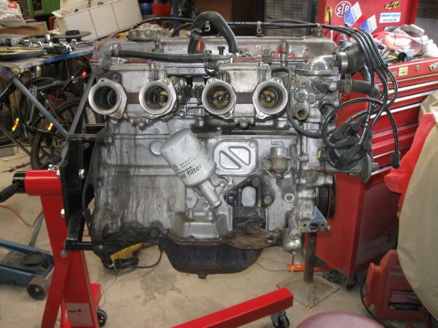

    We're certain its an 18RC bottom end, the oil filter position was RC and fouling on the twin carbs...
  6. #3666
    949
    hI,
    uh, the oil filter goes in the same place regardless. Just uses a different and shorter oil filter the 18rc filter does foul on the carbs. Anything else that makes you think its an 18rc bottom end yet?

    Toyman told me it's an RC bottom end, he and Scrote have been helping doing most of the conversion, I usually just run around trying to screw things on the wrong way for 20 min before realising! I'm sure there were other indicators but the one for me was that the giant 18RC oil filter was on the engine, not to mention that the long RC oil feed tube was on there, so unless the RG ever came out from factory with an oil filter setup that fouled on the carbs I'd say I have an 18RC bottom end!
  12. #3672
    2,144
    My 18RG, complete with engine number starting with 9, has an oil filter that fouls on the carbs when you use the wrong filter ie the 18rc filter
    Now - RA23-WRX
  13. #3673
    6,684
    The long tube up the guts is a worry.
    Like has been said though, the best way to get assistance is to provide a photo of the block with no head.

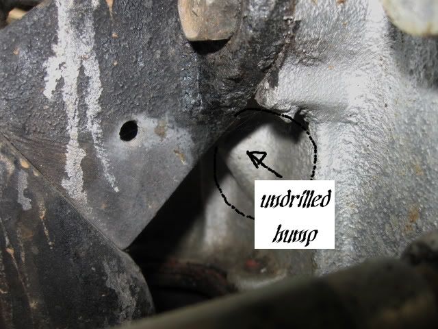

  14. #3674
    Eltham vic
    1,584
    the dipstick hole in a different spot ?\
    this is an 18rc one
    the dipstick enters through the right hand side engine mount
    with the 18rg its on the lhs through the engine mount
    so if your block is an 18rg it will have the hump for the dipstick but not the hole in the right hand side
    this is the oil filter size we used
