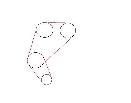

    As i haven't finished pulling down the motor yet (i left my tools at work lol) i need to know a few things about the timing setup. All motors spin the cams at 1/2 the speed of the crank. What i would like to know is if the Gear on the crank is 1/2 the size of the gears on the layshaft and head, or if it's set up differently. From what i can see, she should look a bit like this, no?
    If this is the case, it should be totally possible, using the Layshaft gears to the upper timing setup as a sample for diameter and tooth spacing, and the camshaft itself as a sample for bolt and key spacing, to have a pair machined up.

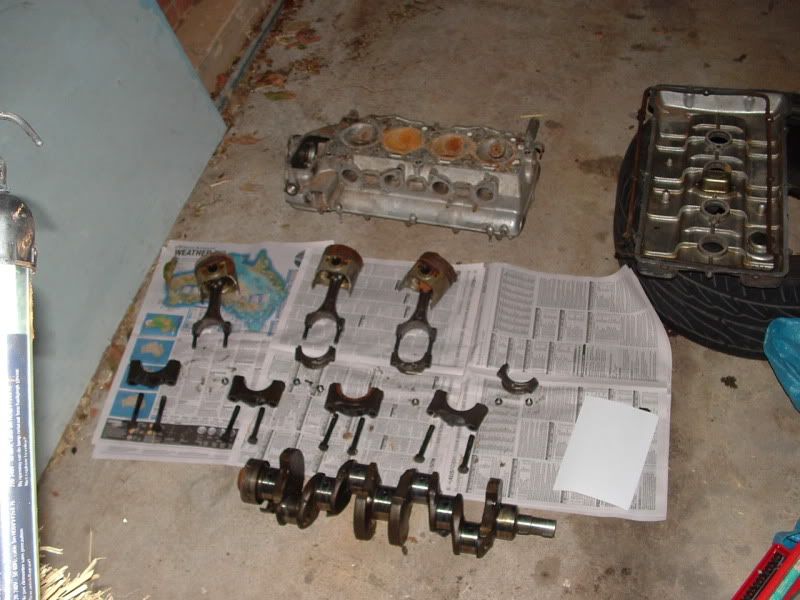

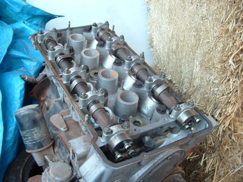

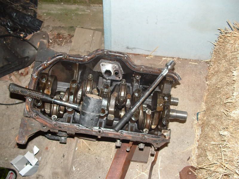

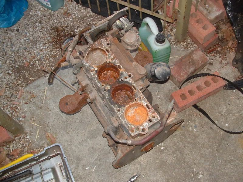

    It would seem i am in luck then. Cams have 3 bolts, and are stamped xxxxx-88210.
    Stripped it down today - pictures will tell the story
    Initial inspection deemed cams, shims / buckets etc to be in good condition. Gasket is still in top nic,as are the cam end seals.
    However, once pulling it off, it was a bit of an eyesore at first glance. Valves will need to be ground, but all corrosion present was brushed off.
    However, this made me swear. very, very loud.
    Fortunately most of it is just a bit of sludge and surface rust. clearly it's been stored well then I cleaned it all up and proceeded to pull it down.
    Bottom end proved to be in quite good condition. Bearings were perfect. Crank was perfect. Rods are perfect. at least that's some good news.
    And in pieces. pistons 1 through 3 popped out with little to mild persuasion. number 4 is siezed in. Bores look to be in quite good condition. No hone marks, but no glazing either.
    However piston #2 is FUBAR. a chunk is missing between the crown and 1st ring land.
    So, suggestions for pistons? and chain? i got on to romac and no dice from them, no longer made.
