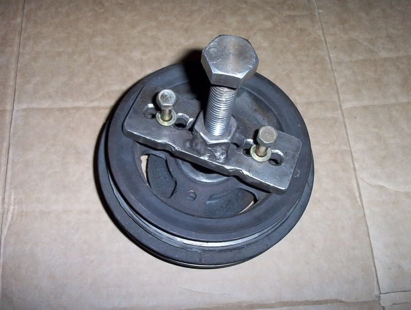

now to get this fucken crank pulley off somehow :S
Elmo, if the crank is already out, spray a heap of WD40 on it, let it soak in, dry it, heat the pulley with a heat gun/propane torch (unless the pulley has a rubber harmonic balancer ring on it), then gently tap it off with a rubber mallet, or use a 2/3 jaw puller (if you have one)
I'd be looking at a harmonic balancer puller, personally, although three jaw pullers also work. If you buy a cheap harminic balancer puller you'll have to get some metric bolts or do some creative thinking, but other than that they work fine.

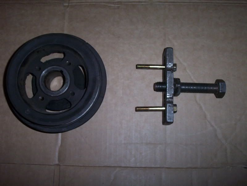

I was to cheep & made my own..Originally Posted by Steve M
40 x 10mm x 120mm plate, 16mm bolt & nut, a few 9mm holes & a 16mm tapped hole weld nut to plate...
the two bolts used for holding, are 8mm x 1.25mm standard thread... for most toyota balancers & steering wheels..
