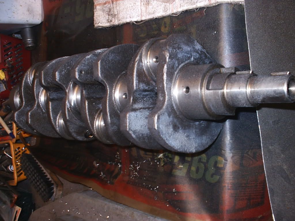

    3TC Crank
    i take a picture sometimes a go at 3T-GTEU late Crankshaft.
    i mean to write left text in picture, thicker than early, but i write thicker than late :lol: i sometimes mixt up words and misunderstund at my text bcz English is not my First language... only bad second one, and do not usually even speak English :lol2: there is noticeable weight difference, i think late crank is more stable in high RPM.. But bought work well in all aplications !! is my personal opinion...

    Default Re: 3T and 3T-GTE CrankS
    all 3T cranks had 8 counterweights... (no one never post a picture or tell 4 counterweight 3T crank !! ) same cranks worldwide... all are Cast Steel cranks. but good quality material, some forged cranks in other car manufacturers can be forged, but sometimes they are quite poor material, so my opinion is that if crank is forger, it wont tell is it good or not... or cast crank is always weaker..

    Crank journals are still the same, but yes there is different style bearings, early one, then what we usually see, and 3tgte style.
    -all 78mm cranks are with 8 counterweigt (3T, 3tgte. 3Teu..) 2 modell new and old.
    -All 2T cranks are the same. (stock ones) 4 counterweight..
    I have seen this talk in old 3tc forum alao and someone take that picture to confirm her opinion, also repair books mix pictures, toyota own.. That in some 3t pics are from 2t bottom, they are just illustration purpose.
    I have seen that some guys says that they have or have open 2T 8 counterweight or 3T 4 counterweighted engine. Usually why this happen, they eont measure stroke ans see only how many counterweight there is + what is stamped to a blog. Some one before have swap the internals already or block....
