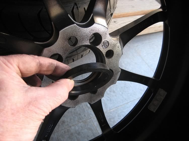

    You can buy rings from wheel shops that serve the purpose of making wheels with a larger hub size still hubcentric, they aren't expensive. I got some from tempe when i went there to get tyres..
    Plenty of people don't worry about wheels being hubcentric, but for the $10 or whatever they cost, i figure it is worth doing

    these jobbies
    3,026
    Default Re: Wheel Fitment
    Yep thats what i was referring to.. there are alloy ones as well
