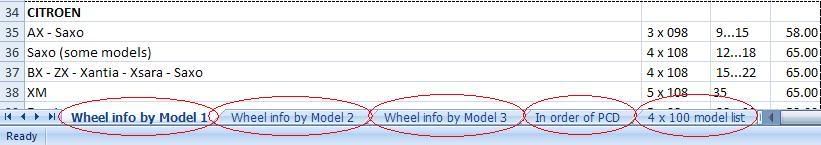

    Car models PCD, Offset & Hub Diameter list
    Be sure to check the different tab's at the bottom left corner of the spreadsheet, as none of list are identical.
    To download the file enter the unique code in the top right of this link and press download
    http://www.megaupload.com/?d=VNT1F50O
    if you don't have Excel you can download an Excel spreadsheet viewer from the internet for free
