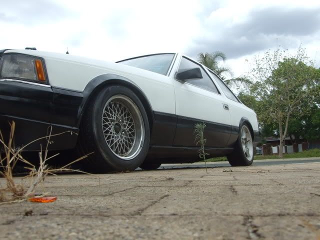

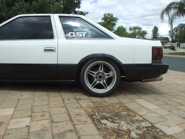

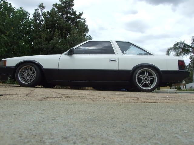

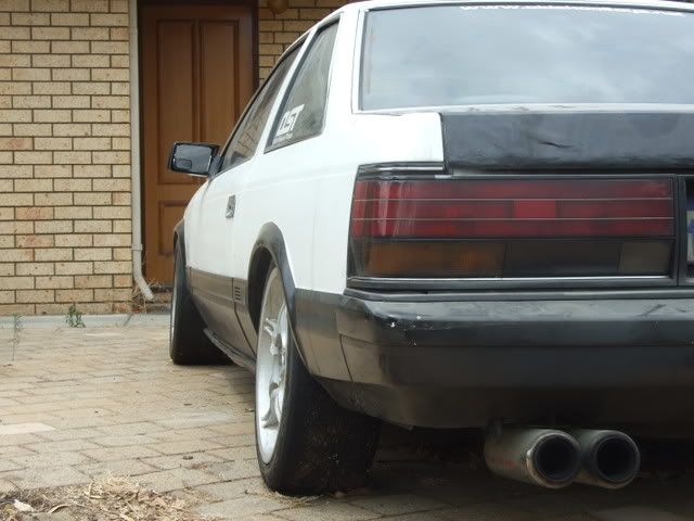

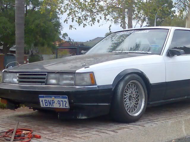

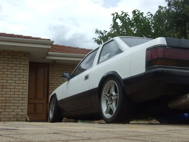

    hey mate.. here are the pics you PM'd me for..

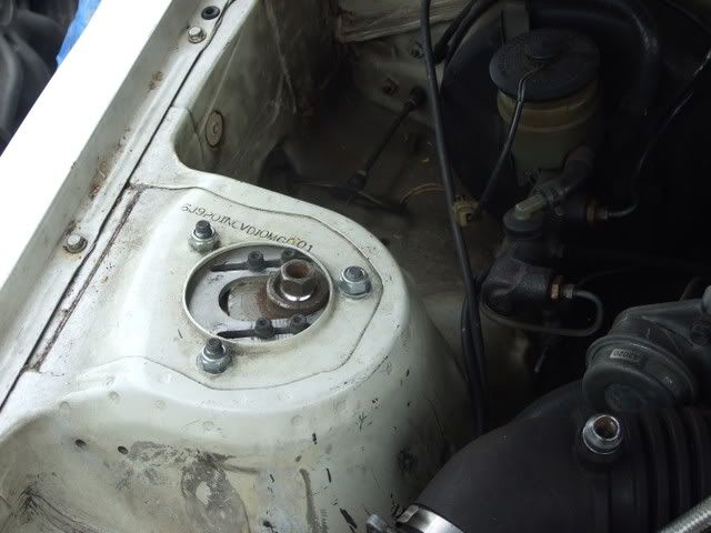

    Firstly we fitted s13 gear to the front... and chopped the springs at the back.... obviously this made the handling epically shit.. especially with a welded diff.. so we stuck some stiff ma61 struts in the back (from memory) and some 14kg 4WD springs my bro got from work.. this worked really well.. unfortunately i couldnt tell you what they were out of.. and neither could he.. he found them in the junk bin of his old work..
    anyway here are the pics.. i recommend s13 gear for the front.. but it depends on what you are after..
    you can see with the way s13 strut tops line up, you can get heaps of extra caster..
    man i miss that old boonga...
    oh, and here is a video for you of what cut springs at the back worked like..

    lol.... looks like its got a hydraulic susp.
    Cut springs worked fine on my old z10 tho, prob depends on how u cut em
    never think using 4wd springs, 14kg thats pretty damn stiff eh?
    sounds like thats the way to go!
    with kingspring they only lower the car by 1.5 inch and they not that stiff......aint shit

    yeah, awesome combination of cut springs and rooted shocks..
    14kg aint that stiff.... well maybe for a daily..
