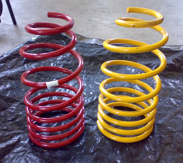

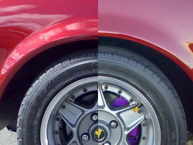

    What relatively straight-forward options are there for lowering an RA23/28? I have just removed my old pedders low springs and fitted a set of king low springs and have probably seen about 8-10mm drop in ride height:
    which is interesting because they both look the same:

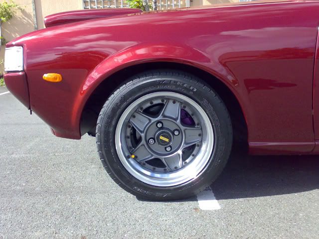

    however, my current ride height is:
    which is just not what I'm hoping to achieve. I'm looking for about 3/4-1 inch lower.
    Can it be done with just springs? It seems that the bump-stops are getting quite close to the strut already. I need new shocks anyway so that's not a big deal. I just want to know if I can get even lower springs with the standard setup and whether they will stay captive?

    o_man_ra23 that's probably not a bad idea. The kings low springs (the yellow ones in the picture) are already sagged I would think as they have been in another car for about 10,000kms and 12 months. I suspect that's why there's a difference between those and the pedders ones (the red ones in the picture) which have a date marked on them 10/06. If I went that way I'd probably use the pedders springs because they are newer. The only problem with cutting and welding is that it would be hard to get a good weld without intruding into the inner shaft, causing the shock not to fit all the way in anymore.
