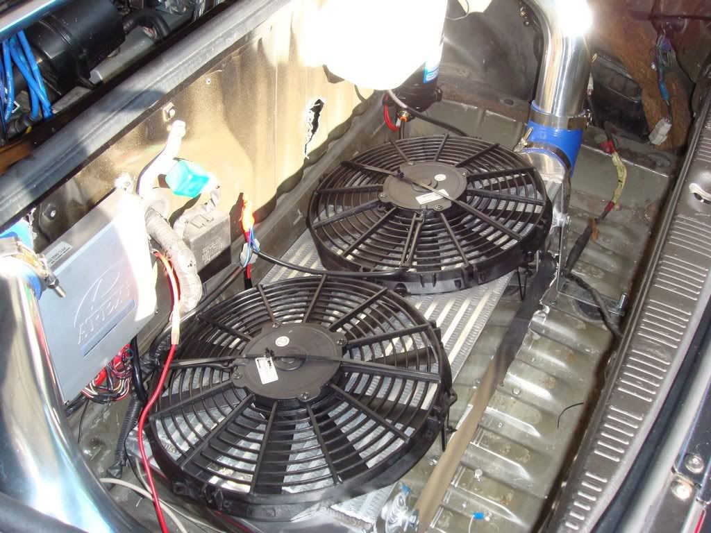

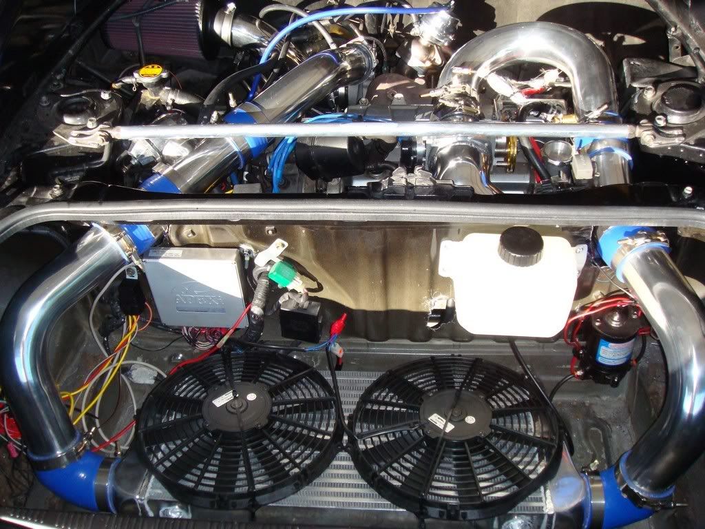

    Default Re: ST215 3S-GTE running stock, what is most boost I can run?
    well I have a mr2 with gen3 head and recently upgraded to gen4 short block, I have power fc ecu and all the bolts on , gt35r turbo, how much boost you guys think the st215 block can take I only plan on boosting 17-19psi on the track 100 octane.I also plan on upgrading the rods with eagle rods and st246 pistons.
    http://www.youtube.com/watch?v=_wC2Z4cH41g
