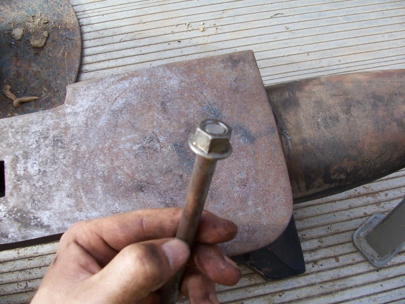

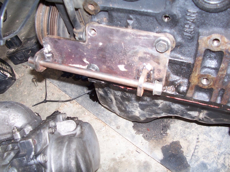

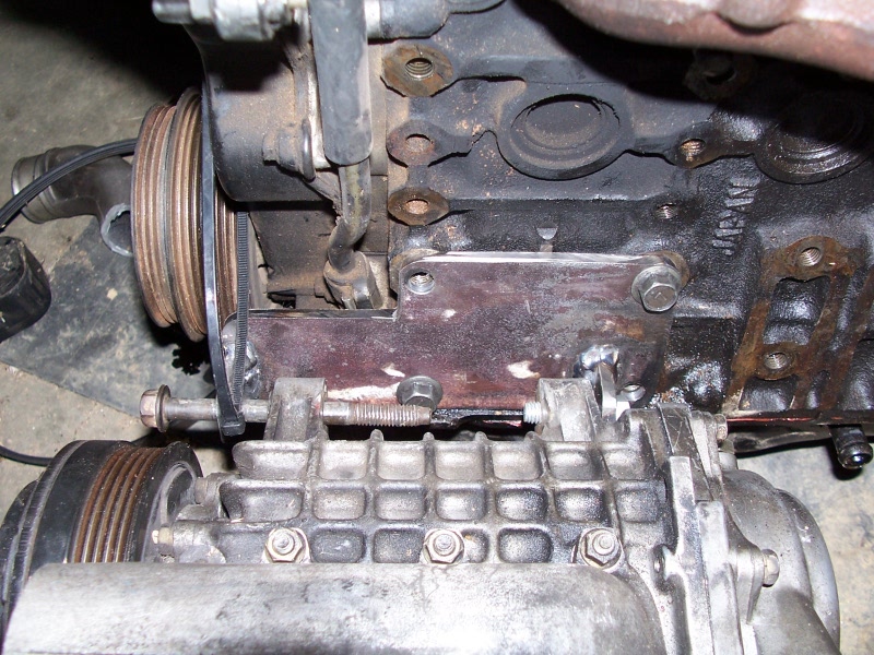

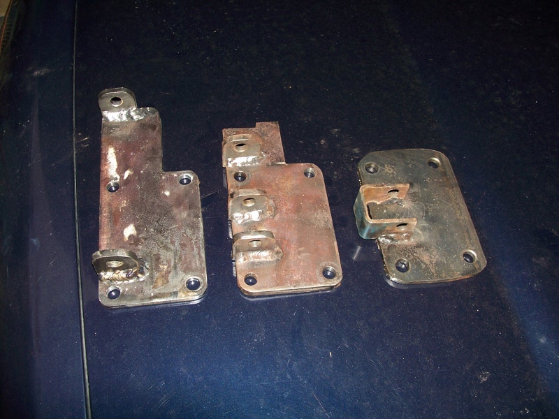

    I'd just make mounts to fit the twinscrew in place where the current SC12 is, make up some inlet/outlet pipes on the charger and use the rest of your standard/current intake pipeing. I made up some mounts for an SC14 to fit onto a CA18DE in my old S13 in an afternoon (I actually made 3 revisions that day!)
    Rev1 on the right, Rev 2 in the middle and Rev 3 on the left.
    Mount bolted to the block
    Made a bolt to go through the bottom mount.
    This is all hand made using grinder, drill press and a $100 stick welder, you can easily do the same thing yourself and save a lot of cash. This is why I'm confused why they need $6k to do something like this.

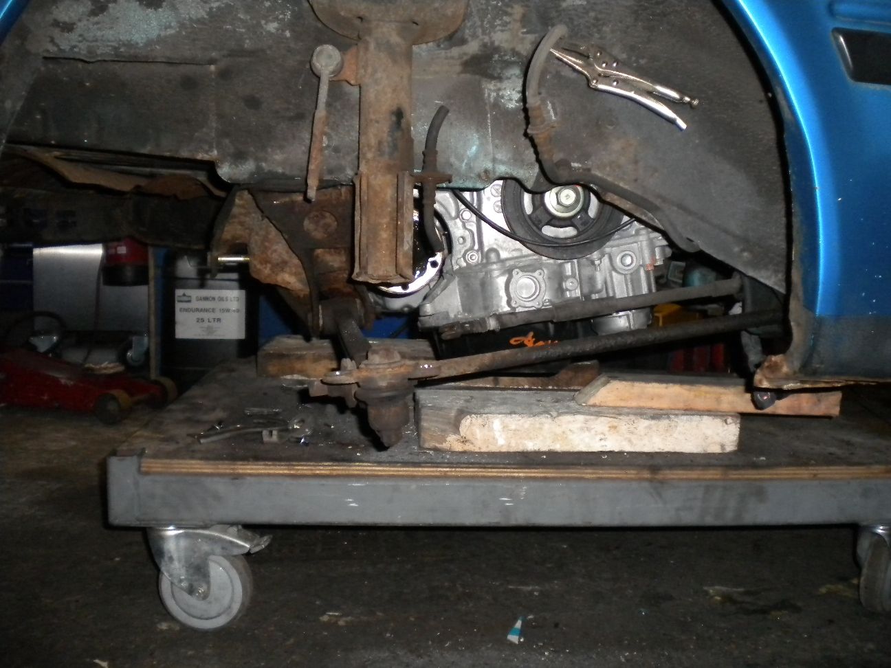

    A little bit of history made today! Say hello to the worlds first 2gr mounted in a Mk1...
    This took some pretty major mods to the engine bay to achieve, and will only sit in this position to clear everything. I had to modify the rear crossmember as well as the front firewall, but it's all in and hanging on its new chassis mounts. Nothing is detailed, it doesn't even have a flywheel installed, this is just a dry hanging to get the engine mounts done, it all has to come back out again. The rear firewall will be reconstructed with a nice access panel for maintenance.
    Sump clearance is good.... but at a cost of engine lid mods.
    It will obviously need a WS TD lid as will any 2gr mk1, it's got to sit at this height to keep driveshafts happy and sump clearance.
    So by far the biggest hurdle overcome, a hanging 2gr in a mk1.
