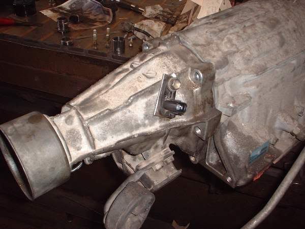

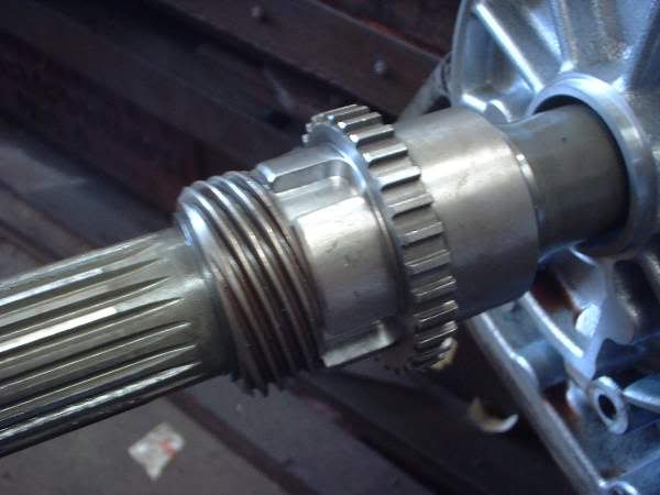

    Here is what I did to mine
    JZA80 box with MX83 extension housing and JZA80 speed sensor fitted in addition to MX83 sensor
    Jealousy is a curse
    649
    Default Re: Automatic A340E Tech Questions
    This is sort of what I was planning. Was any machining required or was it all just a case of swapping parts around?
    The Aristo uses a speed sensor up near the torque converter and a speed sensor near the rear driven off the helical gear. It doesn't have the abs type sensor at all. Fortunately the jza80 seems to have all three types. So it should keep the Aristo ECU happy and the mx83 ABS.
    669
    I do not know which JZA80 transmission you have but the one I had had a speed sensor for the ECU and a speedo sensor and no abs sensor. As you can see in my pictures I have machined additional grooves in the MX83 abs part for the JZA80 speed sensor and fitted the speed sensor to the MX83 housing. If you are a whiz with electronics maybe you can modify the signal from the abs sensor to emulate the speed sensor. My MX83 speedo sensor is driven off the worm gear in the picture
    Jealousy is a curse
