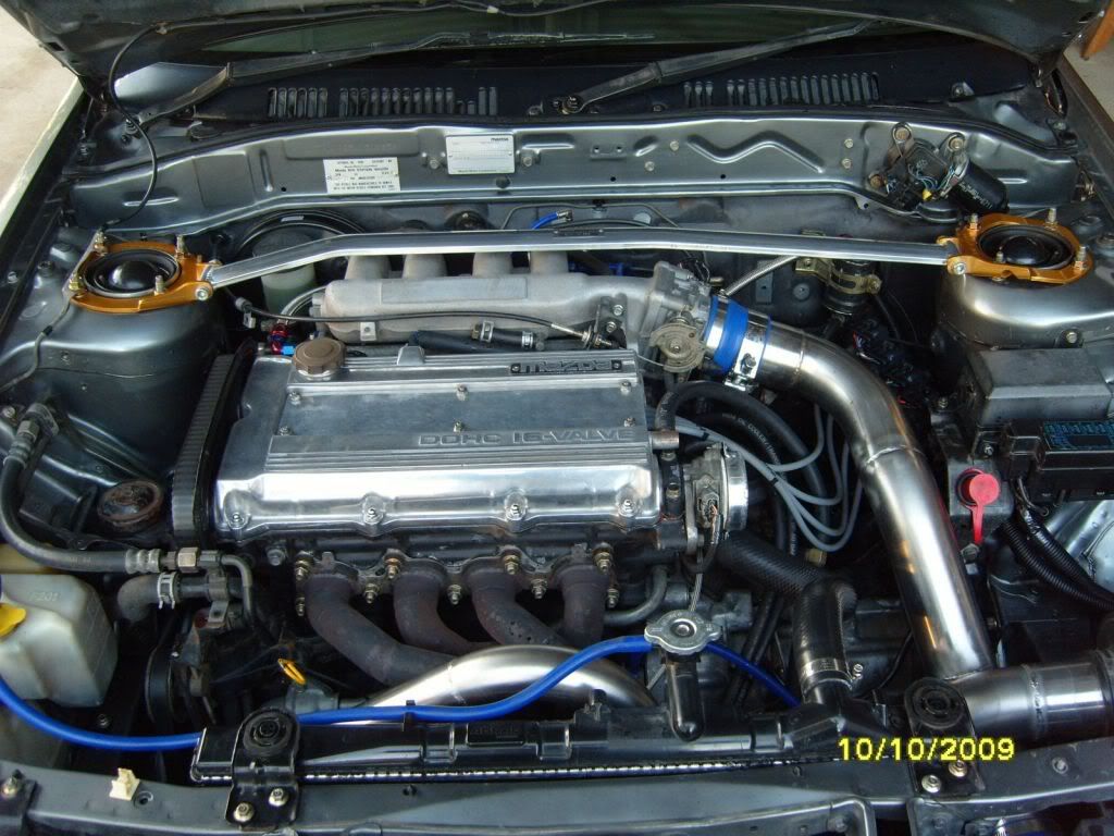

    Exactly hence the need to either get a plate made up to mate the 2 with a flywheel spacer*( i think one would be needed)
    here is a mazda FE-DOHC mated to a e58 LSD gearbox:
    So it is quite possible, and you will have a few less engine mounts to stuff with.
