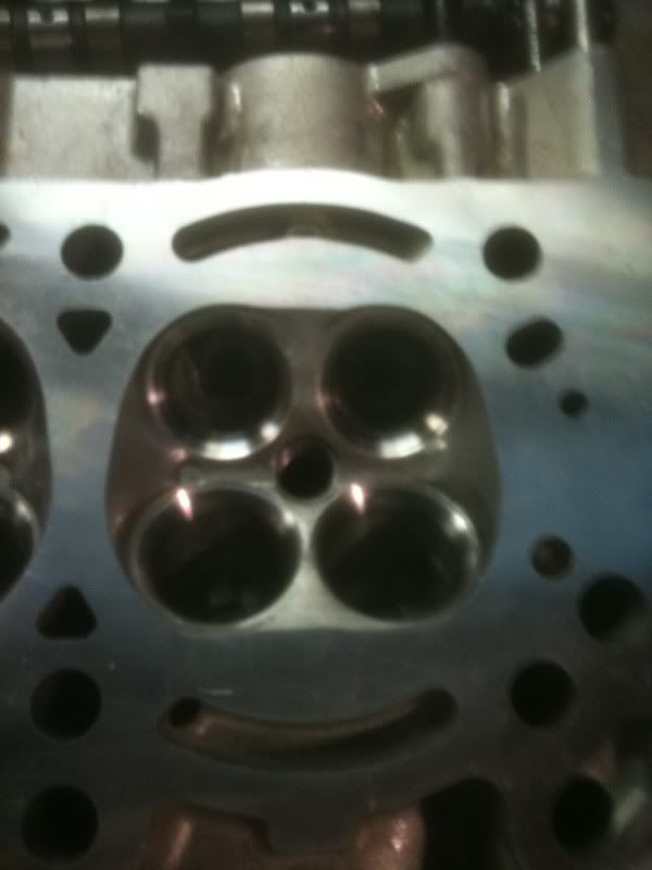

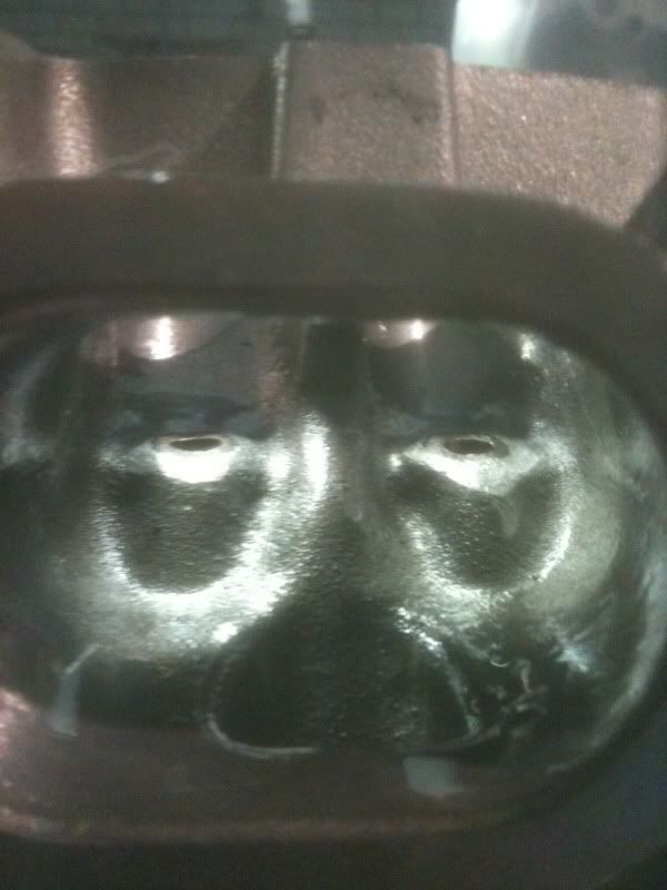

    slightly ported head (around the throat area manly and radiusing the short turn on all ports )

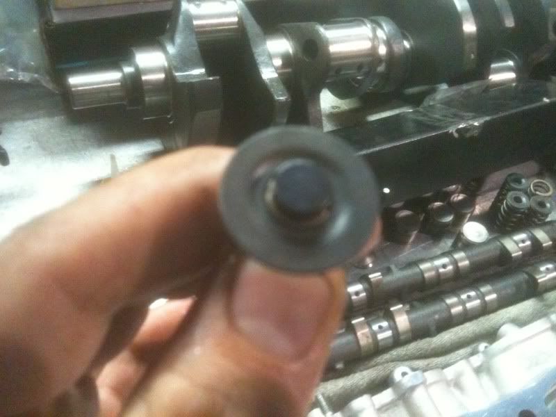

    manly lash caps to adjust valve lash

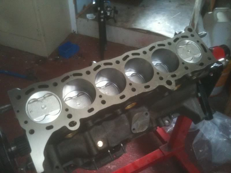

    1mm/.040 o/s pistons with 10 cc dish
    arp rod bolts and head studs ajusa metal head gasket
    king bearings .010" undersize on the pins and mains
    bearing clearence .0015-.0018" all round
    i have decked the block about 25 thou and 20thou off the head
    the pistons at tdc are protruding 5 thou giving me 10.5:1 compression ratio

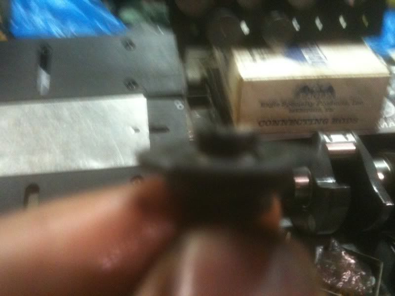

    lash caps
    inlet port

    chamber view

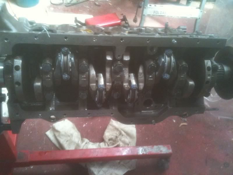

    pistons all in

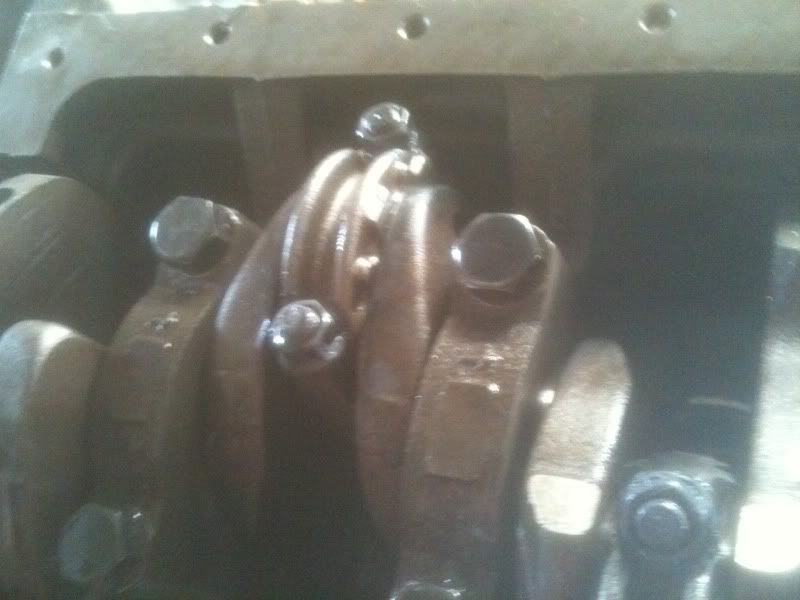

    conrods and arp rodbolts

    90

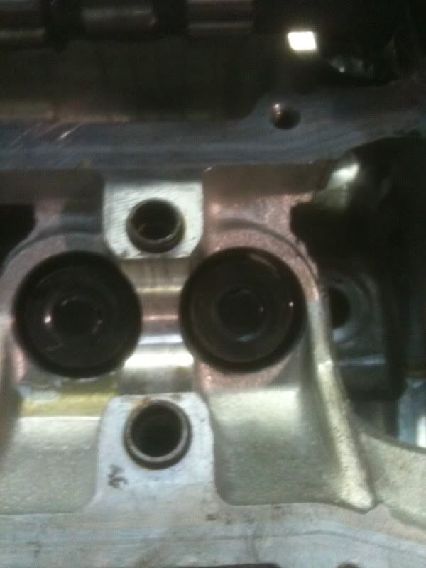

    Default Re: My 7MGE Build
    Not a good idea to completely grind away the valve guides.
    Your valve stem seals will now wear quicker.
    They could have been reshaped a bit to slightly improve airflow.
  10. #55
    816
    Care to Explain why? The main reason for seal and valve guide wear is due to valve train geometry which the 7m has none basically (straight up and down motion, no pushrods or rockers etc) and also the valve being eccentric to the valve seat
    Also on another note the engine is up and running great, cams come in around 3500 rpm and pull nicely from the onwards and sounds pretty beefy idleing I think I may go a full standalone ecu sometime soon though gist tossing up which would be better ecu for a na 7m
    Cheers luke
