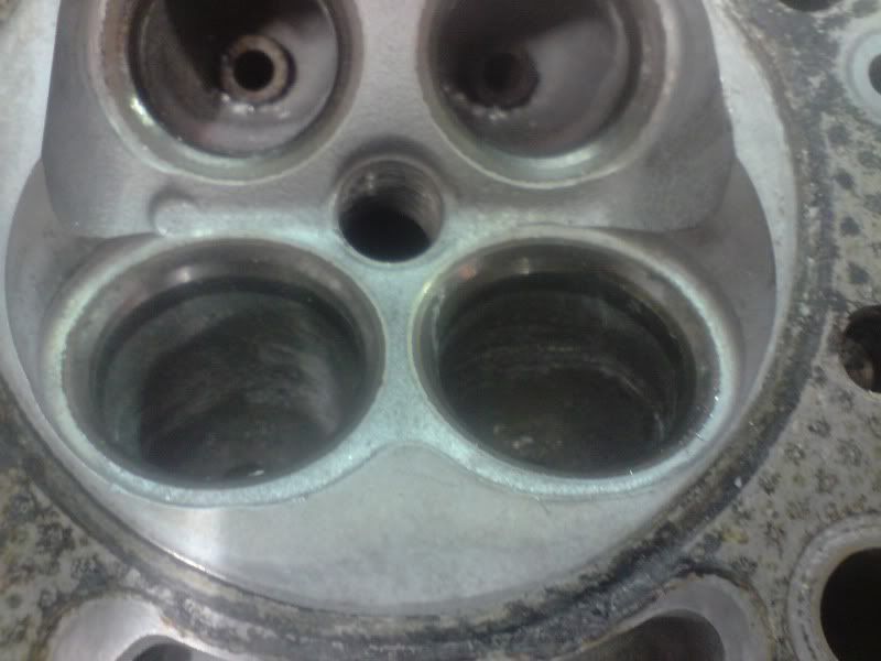

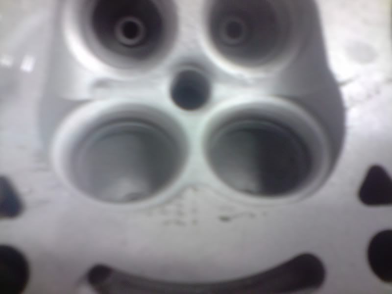

    so far i have done abit of work to the ports (still got quite a few hours work left till im done)
    stock:
    what mine looks like now:

    good work on the inlet ports, uve openned them up heaps!!

    Also regarding de shrouding of the inlet valves have anyone got pictures of a "de-shrouded" chamber
    thanks luke

    more chamber work
