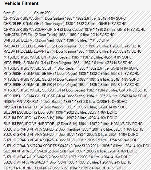

    Quote Originally Posted by ToyTA22 View Post
    I have a Exedy Sports Tuff Clutch Kit part no. TYK-6311HD, Pressure plate number TYC538HD, disk TYD094U. Kit includes throw out bearing.
    cheers ToyTA22. whats your impression of the clutch? heavy on the foot? abused it much? how much power is it holding? oh and did the throw out bearing have it's own carrier or did it need to be fitted to the original W5# bearing carrier? know part number if carrier included? thanks if you can answer.
    I see in the exedy clutch finder it lists all the applicable models/engines that fit this clutch kit. ie Lots! nice to know.
    http://www.exedy.com.au/clutch-finder (TYK-6311HD)
    But more interestingly, the 225mm clutch cover also fits the following, which could open up interchangeable oddities for flywheels if the crank bolt pattern, location spigot and ring gear are a match?
    mitsi 4G54 or G54B
    mazda H20A
    suzuki H20A H25A & J20A
    Nissan CA20E
