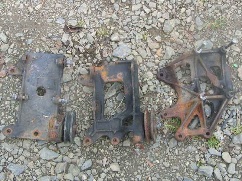

    heres a few 2tg/3tgt aircon brackets. they all mount in the same spot.
    http://toycrazy.net/miscpics/parts-202.jpg
    power steering down low, aircon half way up the block on r/h side.
    ps on recirculating ball in the E7 chassis was available in some markets. ie was optional on the jdm te70 SL coupe with 13t-u.
    afaik you'll only find te72 badged as a T-18 in australia.
    there are no Te7#'s with rack from the factory, as rack doesn't fit under the T sump too well. if you have a rack.. check the rack mounts or the engine mounts for signs of fabrication. as this is what i did, just used ke70 xmember and rack and welded on the te71 mounts for 3tgte.
    jdm ae70 have the option of rack and ps. basically same setup as ae86.
