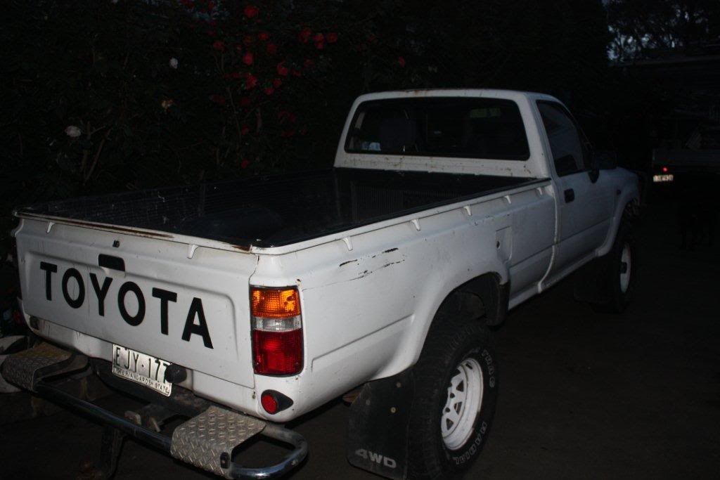

    Over the Christmas holidays i am planning on respraying my hilux and was wondering what the best way to paint the raised toyota on the tailgate in black after respraying the rest in white.
    picture for reference to what im talking about
    Thanks in advance

    Because the tailgate is more aesthetically pleasing that way.
    Very careful masking starting with extremely thin tape would be the only way I would know to perform such a feat. Hopefully there is a better trick (stencil perhaps??)
