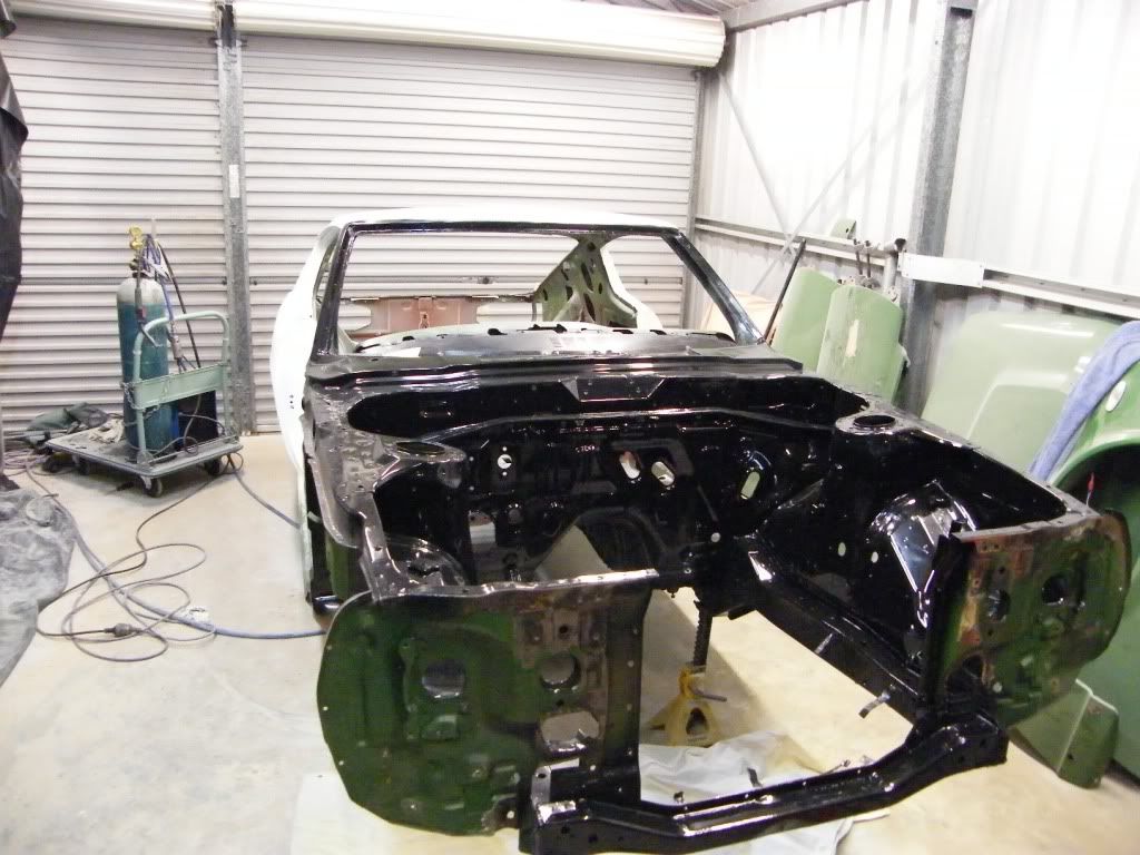

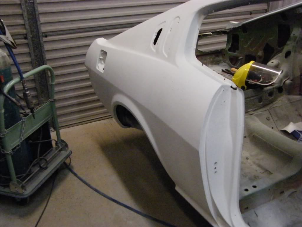

    Pics as requested.
    These are as of about a week ago.
    As for painting the panels, I have been convinced that the best thing to do is paint the panels on the vehicle, with the cavities created by the windows etc covered. Closing up the cavity is said to prevent circulation of the paint dust in the air causing overspray.
    If you are painting a flat colour, it is probably not as important to paint with the panels on, however with a metallic or other paint which has some form of effect, then it is more important to get the layering the same.
