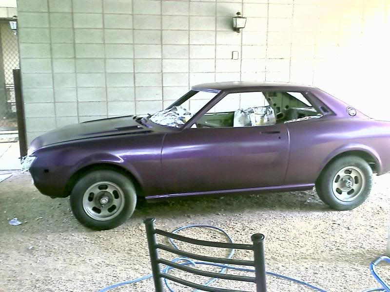

Well I decided to do one more coat, 15% paint, 25% clear and the rest thinners
that looks heaps better
do you have any straight clear left?
if so give it a light block backwith 1200 and give it straight clear thinned of course and that makes it look real deep its looking good

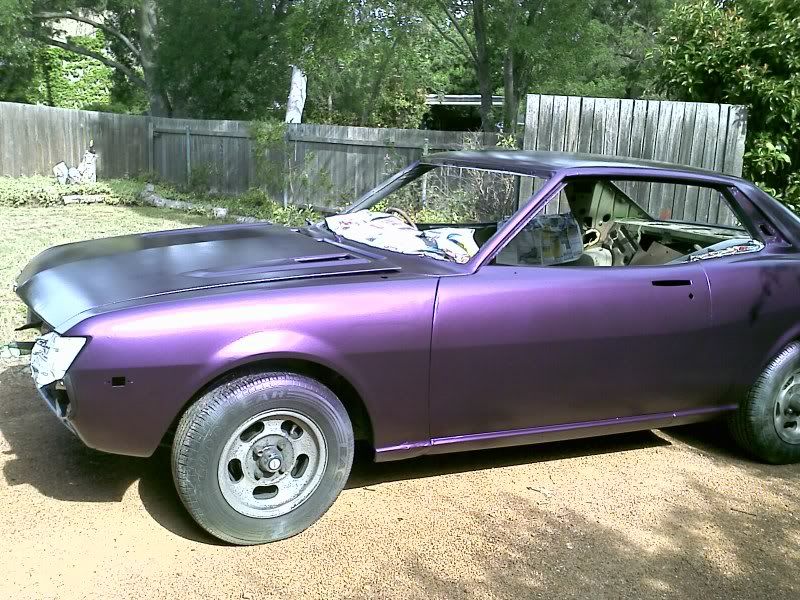

are you going to re assemble the car and give it an even coat all over ?Originally Posted by CrUZida
its a nice red , looks a bit similar to a monza red
good work
ian

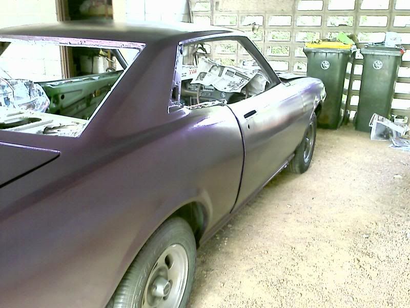

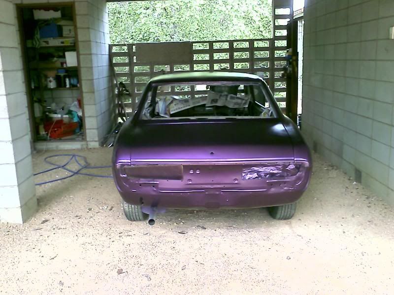

Yeah, about half way through doing it I realised how much easier it would have been to do it while still on the car, however most of the panels had to be removed anyway, so it made sense at the time to spray them off the car.
After the panels are refit I'll assess the colour match (not looking all that flash at the moment). I'm selling the car once its all back together, so giving the whole car a lick is not something I can be bothered doing. The colour match is closer than it was beforehand, and the panels are no longer dented, so its a good result so far.

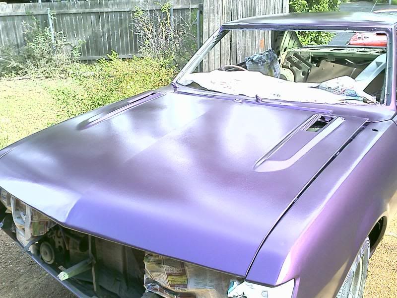

Can someone explain to me the how, why and when of clear?
I was just going to assemble it all, and then give it a decent polish (possibly a 2000grit sand if a polish doesn't bring it up) to make it all smooth and shiny.
I've never bothered clearing anything beforehand, but I've never sprayed anything this large.
Peewee
2013 86 GTS
i wouldn't bother sanding ; depending on the finish now.
i used cutters to bring my corolla up ; at first post clear it was dull ; the cutter smoothed it out and brought up the gloss big time
oh, with metallics ; don't sand then clear. you'll lose the metallic to the paint....just lay on some nice clear (thinned back) and then a coat of thinner last just to even the coats.
you can get a guide to what a coat of clear would look like by wetting your car , clear when applied and polished gives a very similar apperance to a wet car also when blocking back or cutting without some clear coat , you actually are removing color more burn throughs happen on paint without clear
ian
So clear will give the currently *somewhat* dull appearance a nice shine, with less worth than uber elbow grease?
I'll get a nice clear up close shot of the finish. See whether it needs a cut before a clear. It's not at good as I hoped, but given the equipment I have to use, and my lack of experience/knowledge, I'm quite happy with the result.
