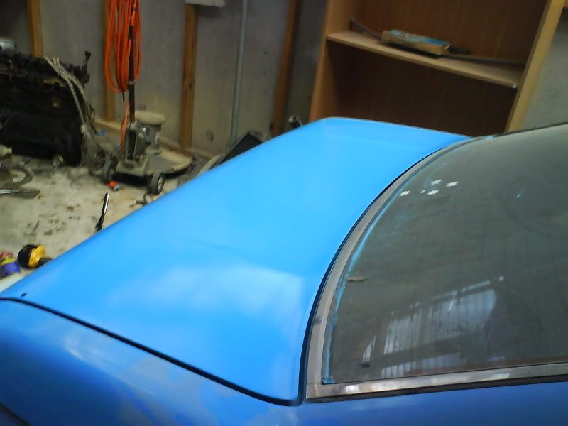

  7. #352
    816
    regarding my 2pac over acrylic theory i thought to my self no harm in trying and this is what i got would be heaps more shinyer if i put clear over it
    gotta love that shine straight off the gun. so looks like the ra40 getting stripped again and painted in 2pac
  8. #353
    4,565
    May look ok now... but i wonder how itll look in a few years.
    Itll probably crack & craze
  9. #354

    Agreed with MWP, the acrylic base is not a solid one, and may shrink and expand in a way that cracks the harder outer layer. Just be wary of that.

    Eltham vic
    1,584
    hi
    it will react after a while
    you can cover your acrylic with acrylic clear ,and you will have to cut it back
    remember, that it was not all that long ago that there were show cars, with award winning paint jobs that were done in acrylic
    also i would advise not to use that polishing buff thats in the background of the last photo lol

    816
    if it lasts 2 years i will be happy i was told by a professional spray painter that because the acrylic has had a lot of time to harden/set (8 months) that it should last a fair while
