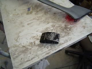

    this is a solid rubbing block
    this is the flexible block
    and this is my favourite THE HAHN DRINKING BLOCK
    ian

    Looks like an ice block to me (but not the type I'd give the kiddies )

    hi joey
    around the lock area you can [PARDON THE PUN ] finger rub the area , that is just with the point of you finger on the w/d paper its ok for small areas where you cant get a rubbing block in also if its around the key lock area it is curved so a flat block would create flat spots if that makes sense
    cos that block of hahn ice is now half empty
    ian
