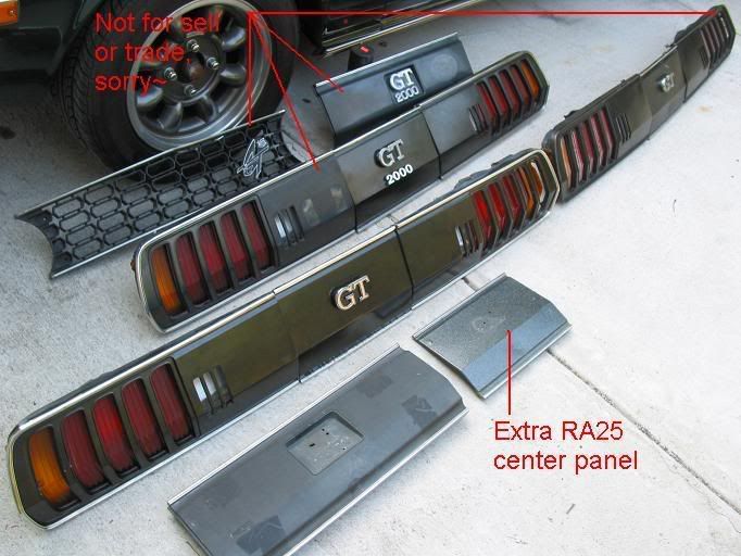

I have been on that site for many years, the only thing I want I cant have. Have you seen the ad for RA25 tail lights he has quite a few sets? not the latest but there was one further down. He wont sell but will swap for parts, unfortunately there not the parts I have. I just want the centre panel for a RA25 as I have the rest. I have sold a lot of parts to these people over time and bought probably more.
