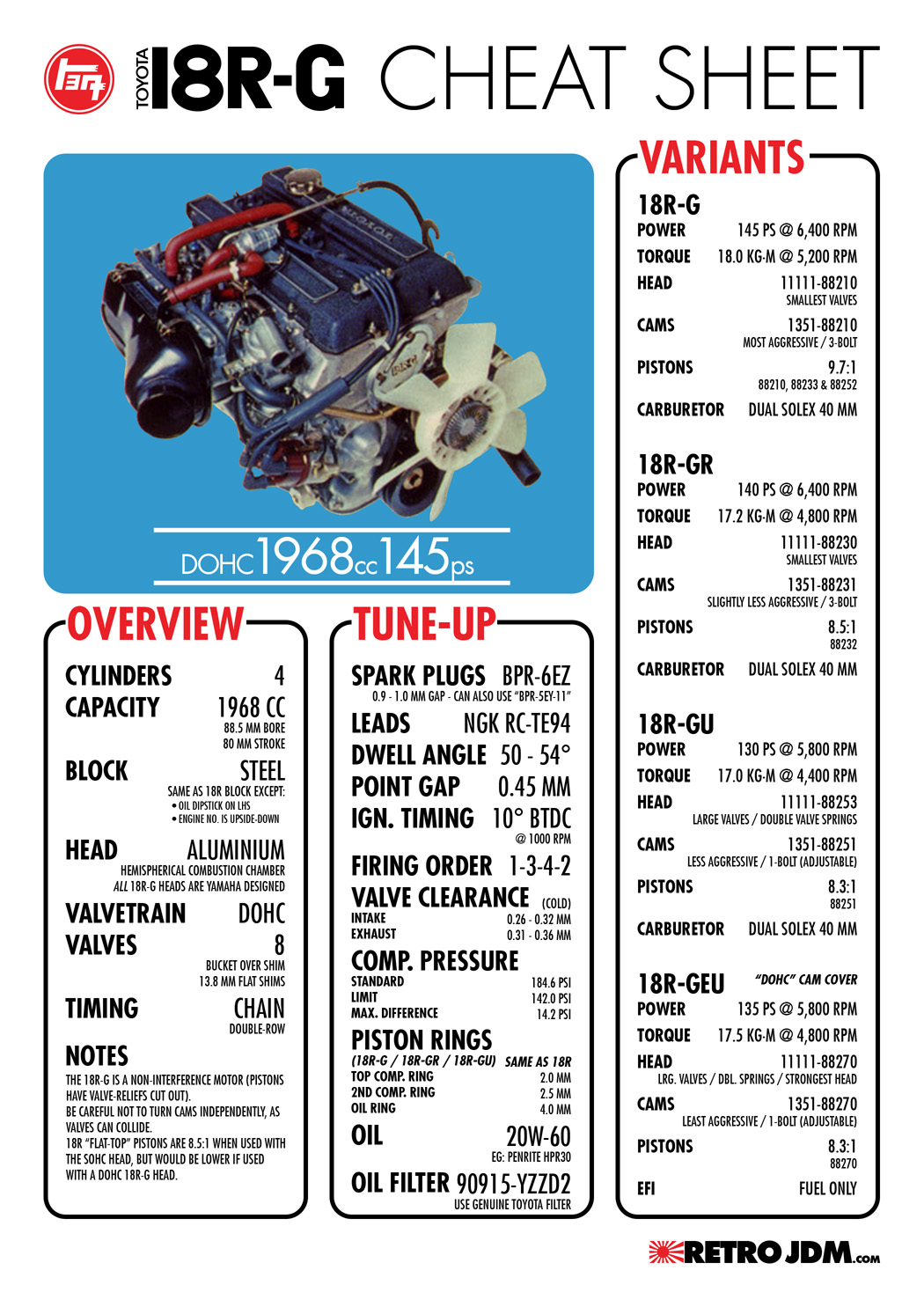

Very nice listing of "Stock" 18R-G OEM builds which are always very useful for the average standard rebuild specifications, however, I was hoping for more input on the modified versions of these engines to get to the legendary horsepower numbers that I have read about in some of the older Japanese Car magazines from the 1970's and 1980's! I have said too much. lets see what other info is out there!
