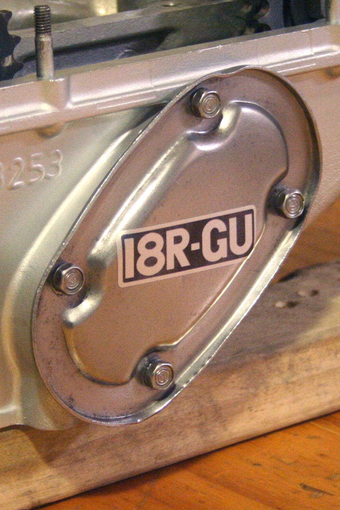

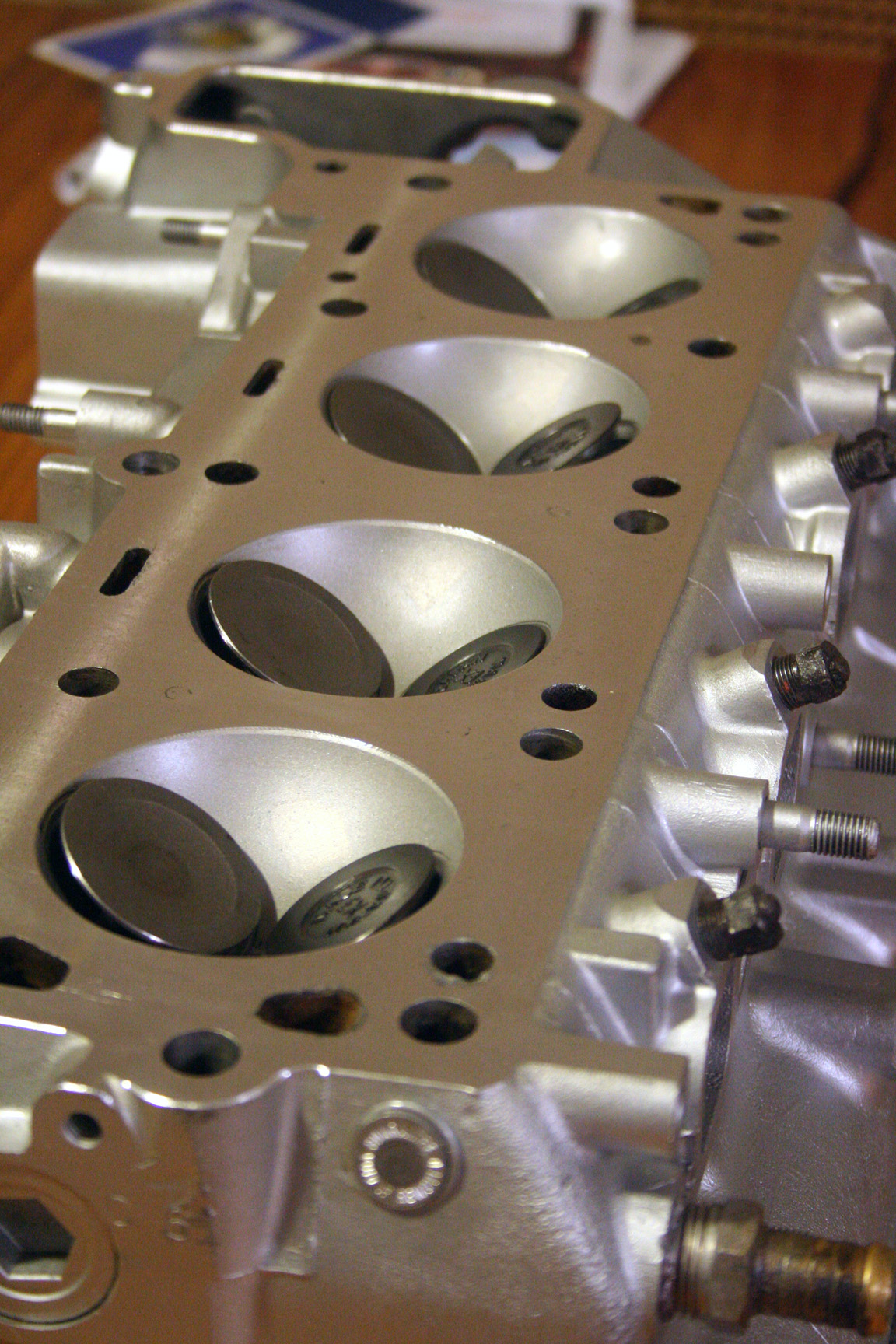

    I thought I'd post this in here since no-one's likely to see it in my build thread.
    I just got my head back from Abbotts Engine Reconditioning in Southport (Gold Coast, Qld).
    Here's a picture of the fresh head, and one of the 18R-GU stickers I've had made.
    I'm super-happy with the work they've done:
    • Replaced all 4 inlet valves
    • Honed the valve stem holes (is honed the right term?)
    • Ground all valve seats
    • adjusted valve clearance with new shims
    • Checked valve spring condition
    • Machined the head gasket surface
    • Cleaned/Painted the head
    A friend of mine dropped it off/picked it up since he knows the guy. I think he got a trade discount of some kind. All up it cost me $400
