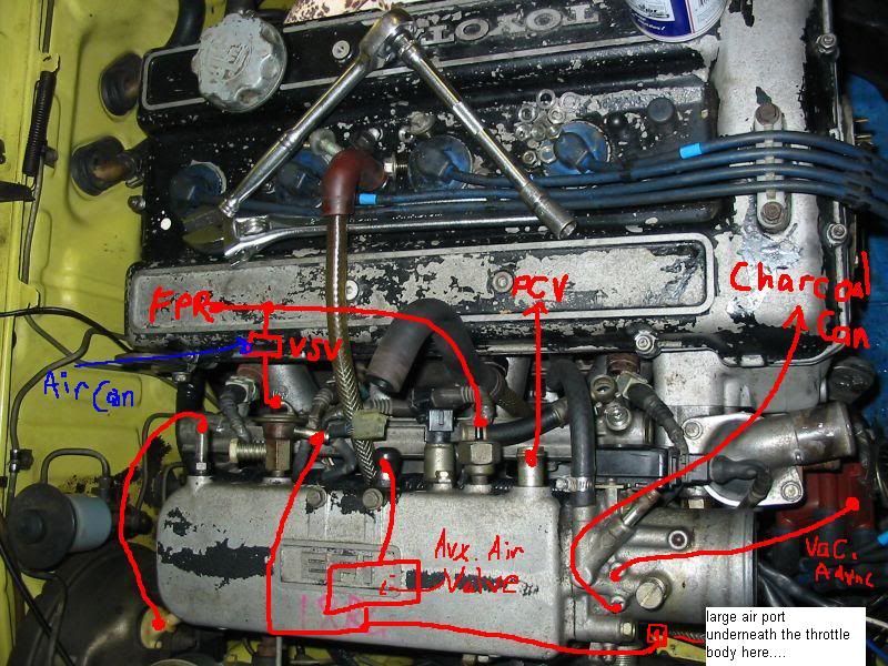

Seems you have sorted out all the vacuum lines and manifold thingies there.
I had to go thru this process years ago when i did my 18RGEU. I ended up removing the aircon idle up diaphram thingo, and replacing it with a fitting to supply vacuum to the MAP sensor (i ran a megasquirt).
As for the IACV, i had one side connected to the port you've shown on the manifold, and the other to the port at the base of the throttle body.
Here's the diagram of the stock system:
Here's what i drew when i was working it out all those years ago....
