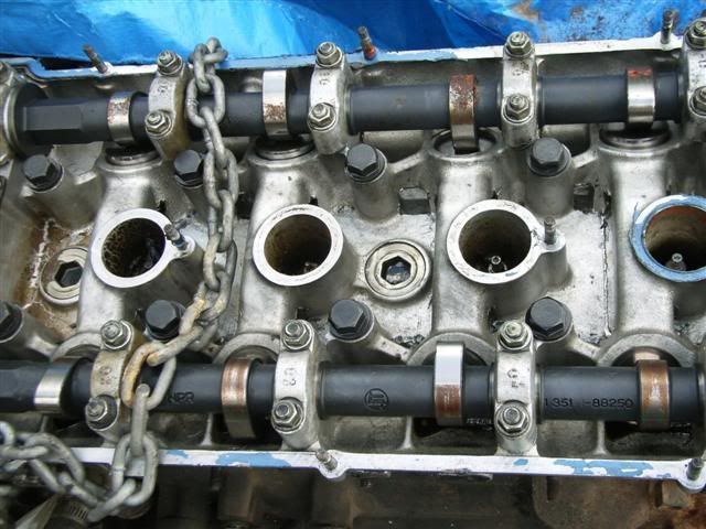

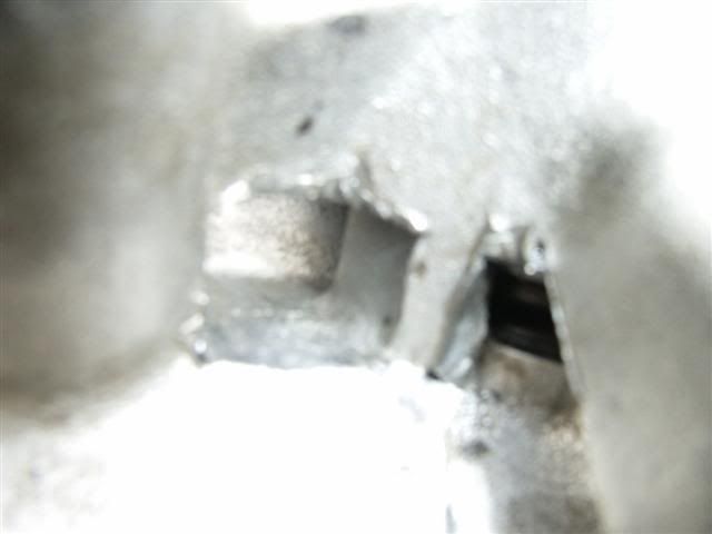

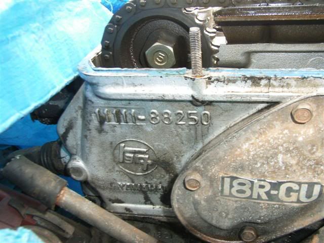

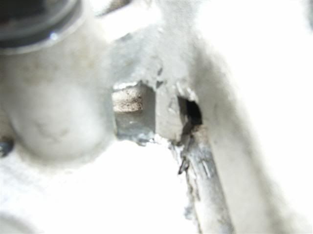

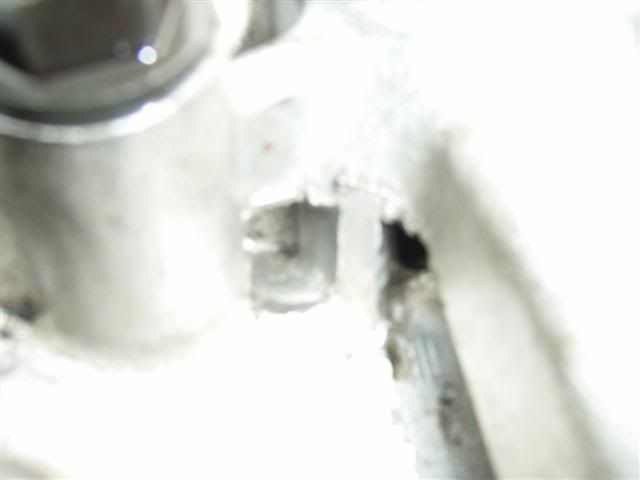

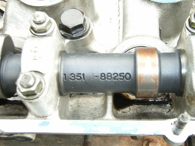

    I have started to rip my 18rg apart for a rebuild.. I have a few questions that I would like to ask.. 1. I have posted some pictures of the head and cams.. I have noticed some cutouts that have been dont to the head and the side of the valves. (not sure who did them) Any one know why they have been done that?
    2. I am not to sure on the timing of the cams or how to remove the timing chains?
    Thanx in advance
    Adam

    interesting... i never did pay attention to oil drains in the 18RG head. perhaps
    these cut outs are extra to that for better oil return?

    Those cut-outs are standard oil drain points. Toyota used a mechanical chisel to clean up their heads, hence the hack marks.
    Removing timing chains starts with the top chain tensioner, then cam gears, the head, sump and timing case.
    Once all of those bits are off, the timing chains should be easy to remove.
    Cam timing is a relatively easy thing as long as you do a good SEARCH for the details, but worry about that when the engine is ready to go back in. Basically at TDC for No.1 the cam timing notches must be vertical. (Cam lobes point horizontally ayay from each other for cylinder no. 1). Gears are adjusted to suit that setting.
    Have a good look through the search topics and you'll find a lot of the info you're looking for.

    as steve said, those holes are standard on all the heads i have lying around.
    On the 88270 head i have a rather large cutout where the front top timing chain slipper goes as well.
    to assist with removing the gears, there is a position on the cam that allows you to either put a spanner on it or a pipe wrench.
    Hold that taught as you undo the bolts on the front of the cam.
    once you have the front bolts off, you can slide the gears off the cams (don't loose the little dowel).
    after that it is all self explanatory as steve has mentioned.
