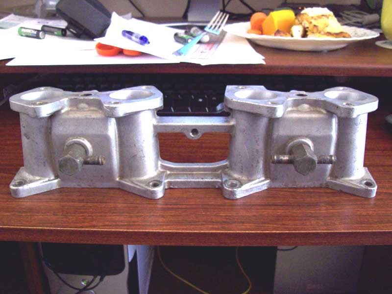

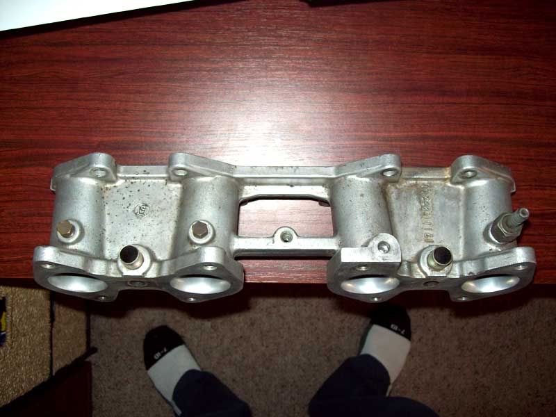

    i ***think*** i do. I'll check tonight along with everything else that i have to do.
    bEn
    Quote Originally Posted by Steve M View Post
    RT104GT,
    There are two versions of the long manifold.
    I want to get my hands on an 88211 manifold as that's what best suits my plans.
    If anyone has an 88211 manifold, please let me know. It is long and water heated.
    I would be willing to swap for one of my shorter manifolds if need be (which fit better in Celica engine bays).
