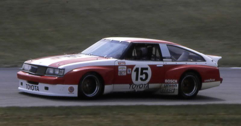

    There is only one way to make them cool, and that's a 152E and widebody;
