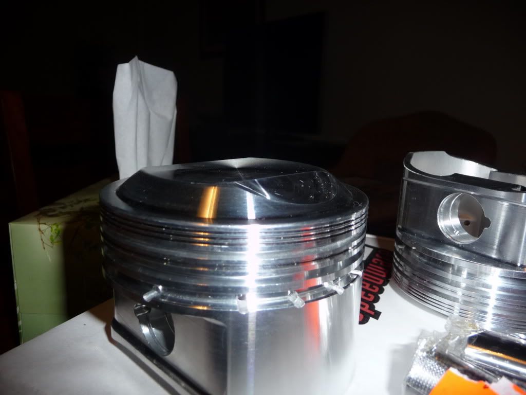

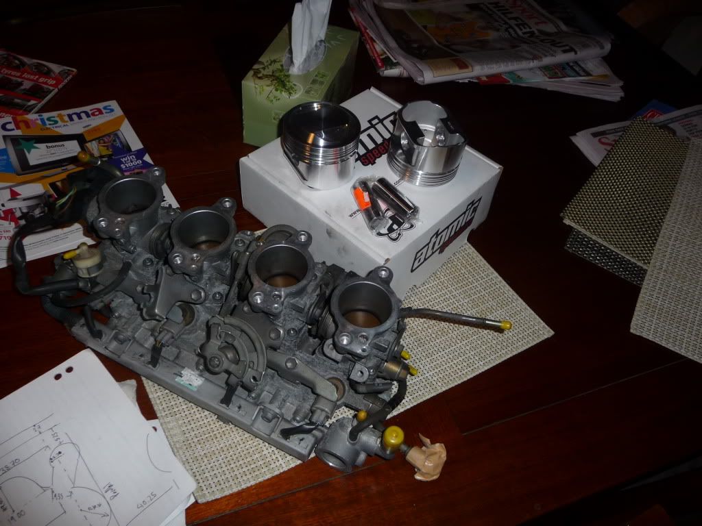

    504
    These should give mine some poke to keep up with you 18RGTE boys, if one of you ever finishes one...

    6,684
    I've driven a half reasonable 18R-G and a poorly tuned 18R-GTE, and been chauffered in an angry 18R-G. I assure you that no amount of lumpy pistons and quad throttles is going to let you keep up. But should make for a very fun drive all the same (and an extremely sexy sound)

    Eh, i only want a mildly rorty engine that makes a good noise. Readily streetable with a sporting streak is the name of the game.
