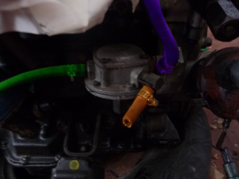

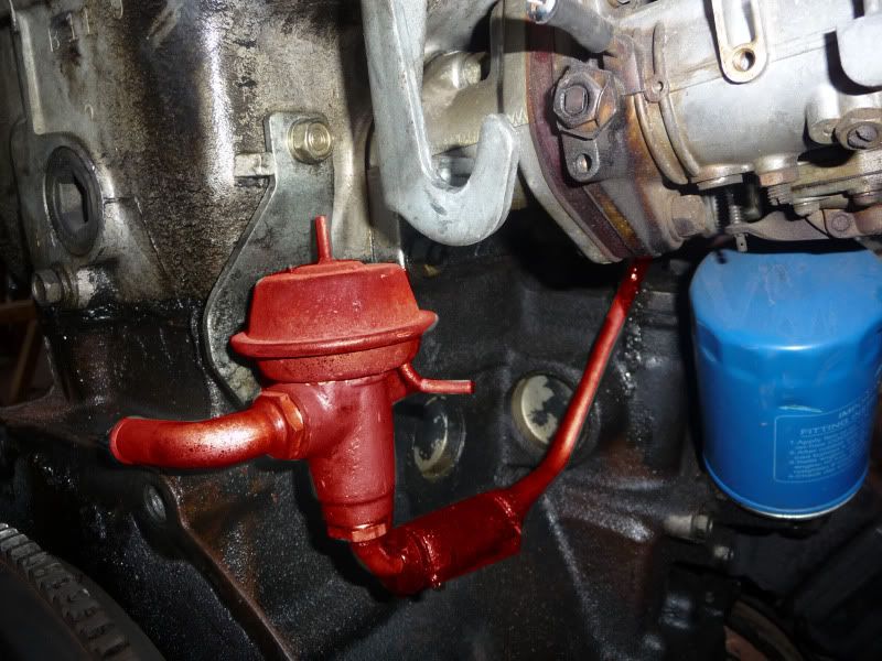

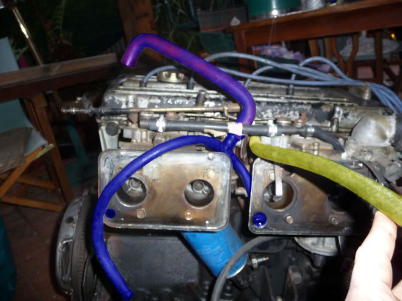

    So, riddle me this:
    Blue / purple = PCV
    Yellow = Vac line to Brake booster
    You might be able to see a red hose behind all of that under the inlet mani... PCV also?
    Red = ????? what the fuck is that?
    Purple = feed line to carbs
    Orange = feed line to pump
    Green = return line????
  2. #2177
    614
    Blue Purple, PCV. YES. The red tube under the manifold is also PCV, YES.
    Yellow was originally supposed to go to an emissions reduction valve that sits ontop of the tappet cover.
    Use it for your brake booster, YES. It is not worth finding one of those valves and dicking around to make it work.
    The first red is part of the EGR set up. Remove it as the systems are never complete and usable by the time they reach Australia. There was also some sort of emissions control computer that was needed to make it all work and they were left in Japan.
    Green is fuel in line from tank.
    The other two lines are fuel out.
    Purple goes to carbs
    Orange goes is return line to fuel tank.

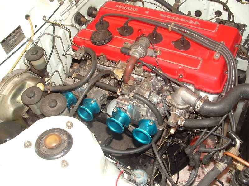

    As an alternative to having my 'blue' pcv hoses (first picture i posted) jammed into the air filter backing plates, i was thinking about teeing it with the hardly-visible red PCV hose in the first picture, even if just to neaten it all up a bit.
    No reason why i can't?
