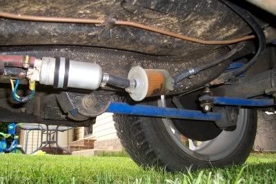

    more to the point what did it do when it stopped? sound like things breaking and oil smoke out the exhaust or just stopped like turning it off?
    fuel pump might be the culprit you have to work your way back.

    yep. that top pic the thing with the strap around it is your fuel pump
    now for the big ask. its a bosch - grab the numbers off it
    then we can figure out what pump it is and what pressure it does!

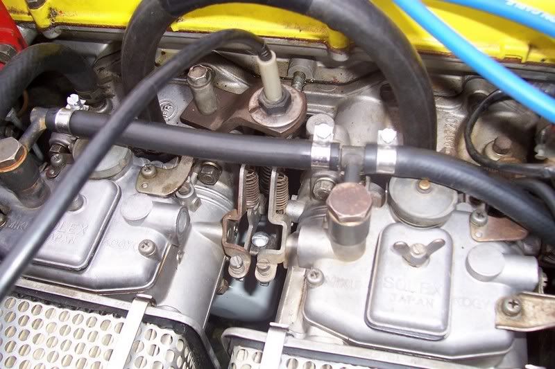

    dudette, where is the washer? or you talking about the little guy on top around your throttle cable? i don't think that will be causing grief mate

    ideally it should be a lift pump so low pressure.....

    I dare say that the big washer there is to stop the accelerator cable falling through the hole (which is probably too big) in the bracket. Normally the older twin carb engines run a linkage setup so I would assume that someone has converted this at some stage.
    That pump sure does look like a high pressure unit, more suited to EFI than a carb setup.

    well I cant for the life of me find any numbers on the pump...I stuck my camera in there from every angle and found nothing...

    At a guess I would say that the part number is directly underneath one of those cable ties (at least that is where it is on one of the VL turbo pumps I have lying around here).
    If you're keen you could always cut off the cable ties and have a look.

    Theyre not cable ties - they are wrap things with bolts and stuff - I will get back under there when this weather goes away again (another storm) and try and undo them to see...its a pain the car is SOO low to the ground!!!
    LMFAO!!! Theyre called hose clamps Dont worry, generally when talking to car nuts, for parts you dont know the name of insert "thingemebob" or "whatchamacalledit" instead!! They usually suffice! (My two favourites )
