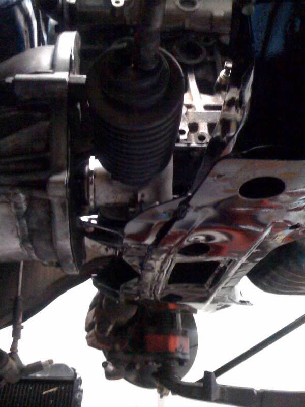

well sorta, heres my update
thanks to eddie/Shelldrake for the pics. Now as you would be able see the ends are seriously reinforced, even more than the pics show. Fits straight in without big oversized holes or anything unproffesional like that.
Now I have found some complications;
crossmember #1: stock A mounts, fits a 16V engine but won't clear the dizzy base on a 20V.
crossmember #2: engine mounts moved forward 20mm, fits the 20V nice but the A to W adapting bellhousing lightly touches the tunnel.
crossmember #3: engine mounts forward 20mm and down 20mm, fits nice all over but the sump is under the crossmember, no way around this.
So yeah I am ready to start some mass production as soon as I go to the wrecker and buy a pile of parts, something I am not looking forward to.
Comments welcome
