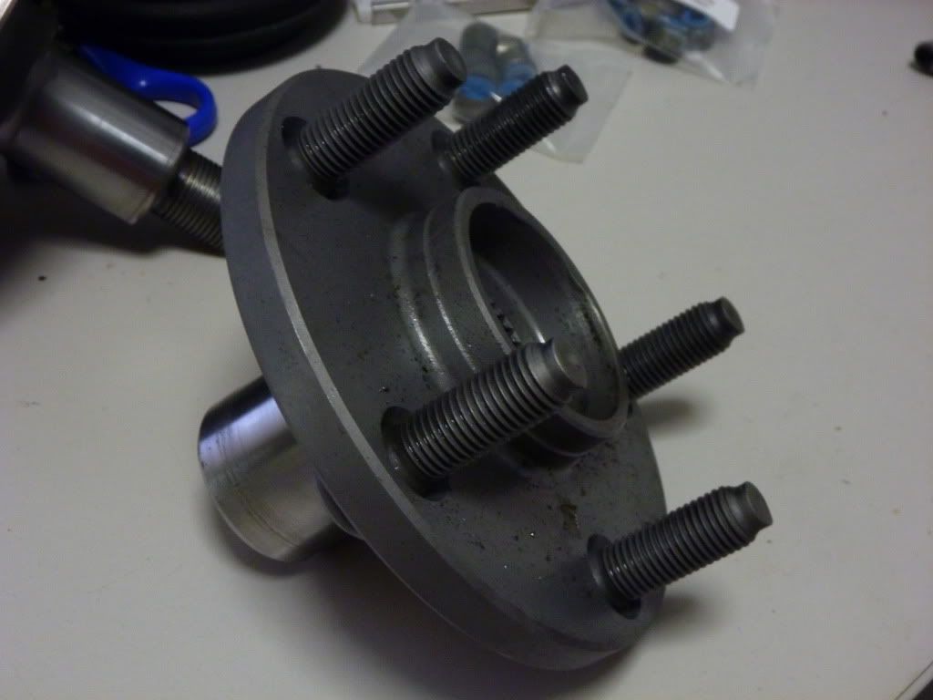

    Hello
    How is this conversion going?
    I have got a Celica rear stub axle off a ST204.
    This does require some machining to fit the AE 101 rear rotor over the flange, Due to the bigger diameter of the celica disc rotor centre. Rather than just machine it down to 125mm like the Corolla one I machined it with a step so it doesnt break through the holes completely. I had a AE101 rear rotor at work to test fit this.
    The stub diameter is 30mm.
    I need someone to measure the Corolla stub axle as i wasnt going to pull apart the ones I had just rebuilt.
    I have included some pictures.
    The front drive flange is off a ST204 as well and definitely fits a corolla with the 55mm bore disc rotors.
    I need to know if the AE101 rear disc is the same as the AE111. The AE111 does not have the handbrake inside does it?

    Ok
    It looks like the only difference is the spindle diameter that passes through the bearings and the seal diameter. The Celica one is 30mm, while the Corolla one is 28mm for the bearing. The seal area is 42.3mm for the Celica and 41mm for the Corolla. All the lengths liik fine. Can you tell me the thickness of the flange where the wheel bolts on? On the Celica it is 9 mm thick. Also is the thread 20mm ?
