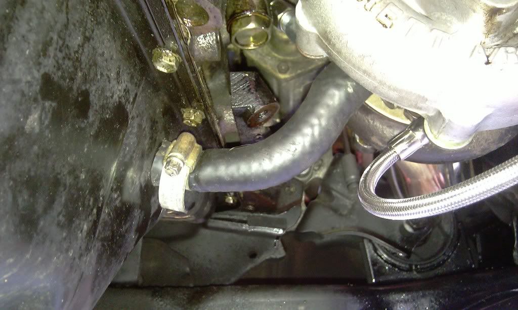

    Call me silly, have you got the oil and water feeds to the turbo around the right way dude. I could be looking at those last pics wrong as i cannot see the side of your block
  6. #171
    Jul 2010
    198
    Default Re: Micotech 4AGTE
    Quote Originally Posted by Grega View Post
    Now that would make me i look pretty silly
    nar that's just the way Ive plumed them looks like it but there right

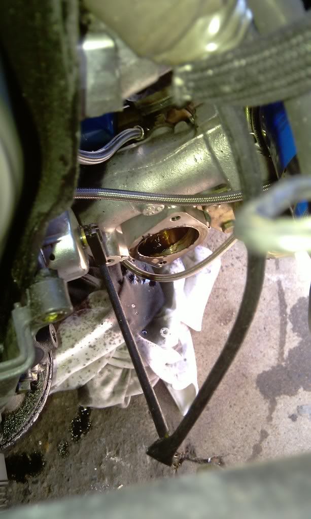

    yeah was thinking about it more this afternoon, the oil on the inlet side of the turbo means there is oil getting there, just, either too much (no restrictor?) or seals are shot. esp on the inlet side, although, you do appear to be getting it on both sides aye looking at those exhaust pics....

    Pulled the oil return off and started the thing !!! still had some oil coming out but thought is was residual so i cleaned the throat, and repeated this for a for about ten mins while checking the oil !!!!! (of course)
    Here's were i found that the oil drain from the sump was blowing oil out!!!! now we all no what that mean's ( the drain port is to low !!! F@#K WIT )
    Continued after plugging the drain and checking the oil and found that the oil in the compressor throat got less and less till there was only a slight bit of blow out when i gave it some rev's....
    Now the sump must come out and have a new port put in... Think i will put a huge one in (20mm) the rear of the sump and clock the turbo back a bit and see if that fixes my prob
    Ps im a complete F@#K WIT !!!!!!!

    i have a 0.8 restrictor so that's not a factor !!! just my stupidity !!!!

    ah OK. hmm, too low. strange.
    the return didn't look that low mate.
