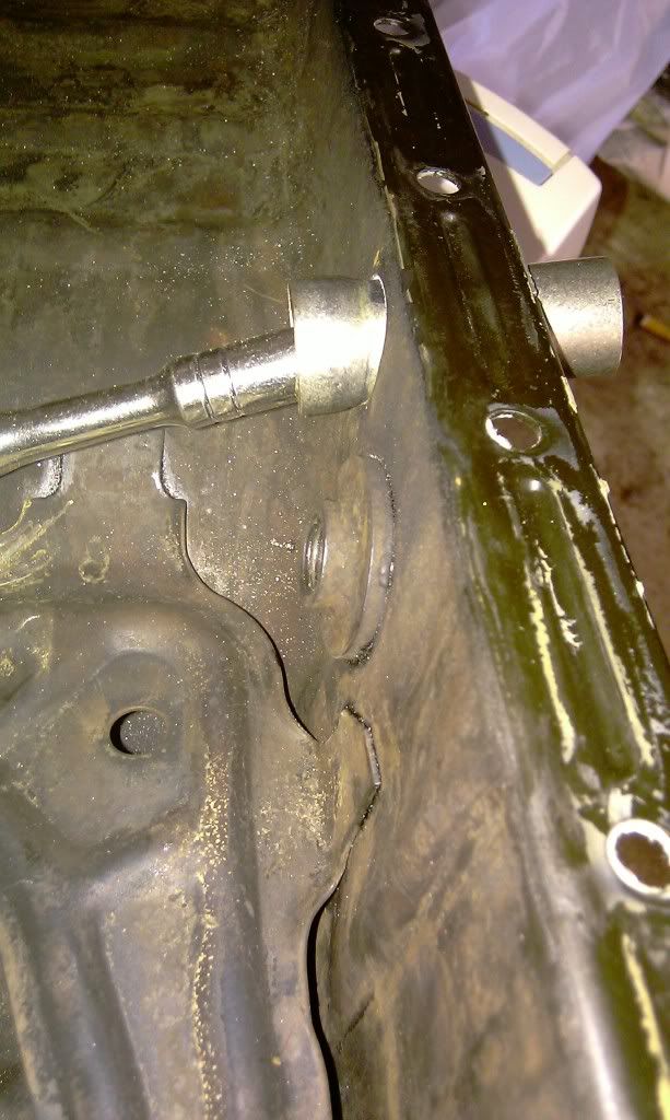

    New oil return is angled down !!!!!! And is 17mm ID if this doesn't work than it has to be stuffed !!!!!!!!!
    Will be welding it in tomorrow !!!!
    The return is belled at the end (inside the sump) to 19.5mm ID Just in case

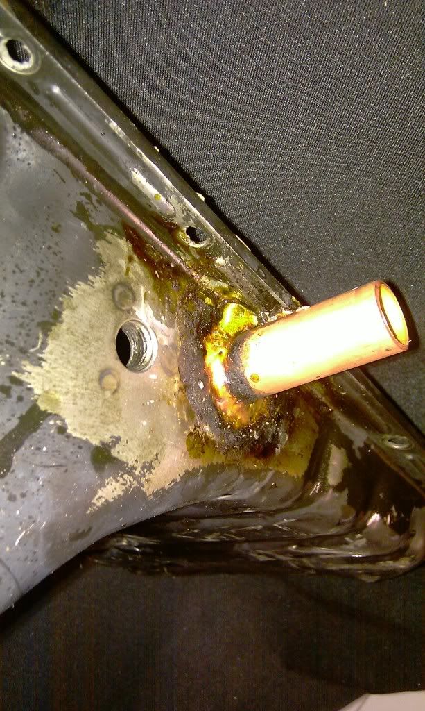

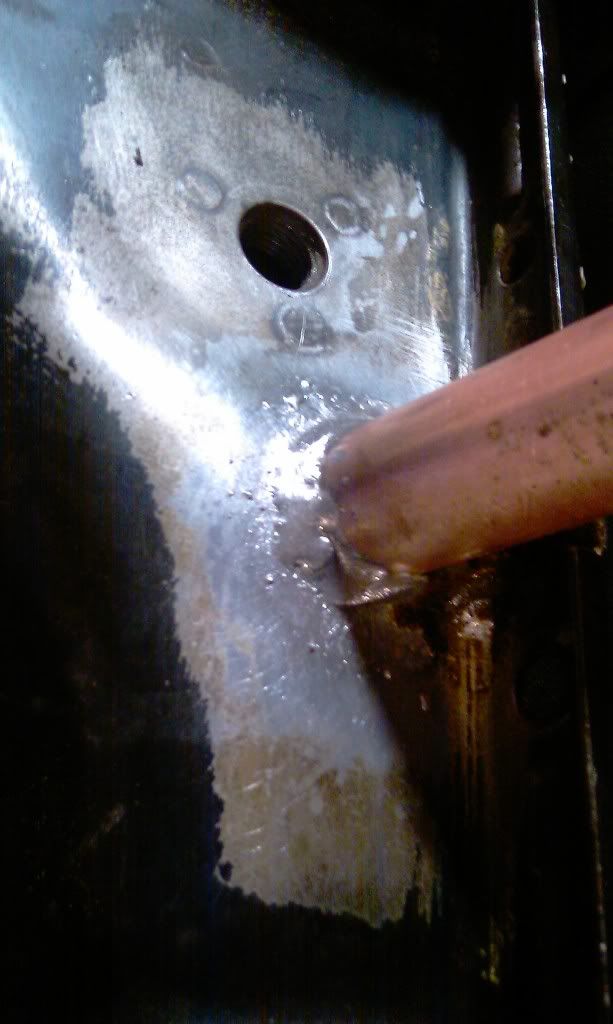

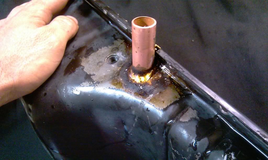

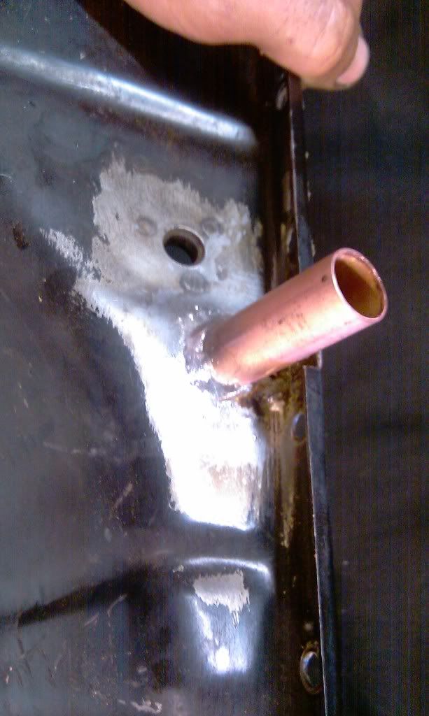

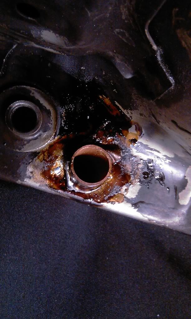

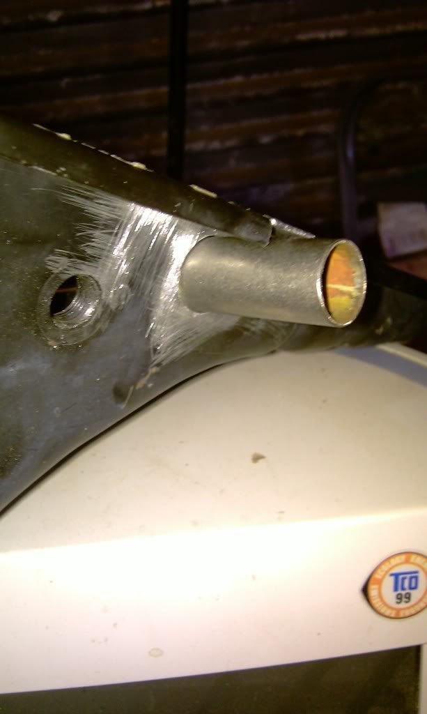

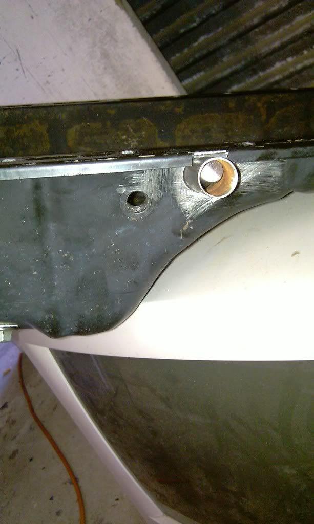

    Here we have it
    Before i clean it up so there's no cheating
    Yes its solid to the lip to just for strength
