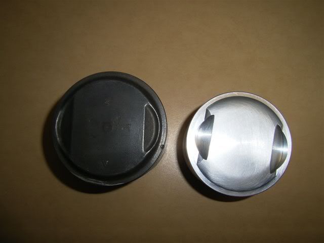

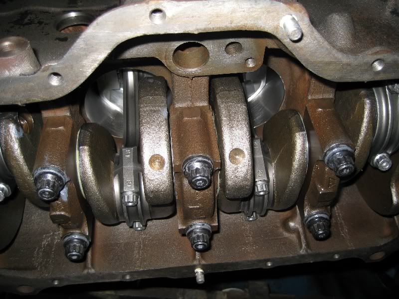

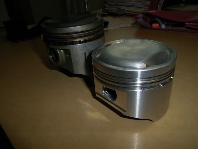

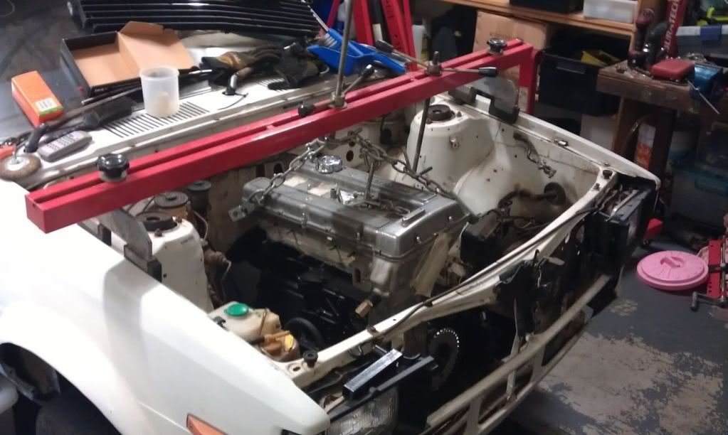

    ... i just found a bunch of pics i had stored
    First up we have the lovely forged pistoons.
    .... the bottom end that will hopefully never break.

    .... and where it currently lives.

    Quote Originally Posted by The Witzl View Post
    In a box!
    OMG.. a beautiful engine like that... going into a 1980s box! hehehehe
    seeyuzz
    river
  14. #944
    3,164
    Default Re: The 18R-GTE reference manual ...
    yeah... but its a fucking lightweight box.
    ...... butt scratcher?!
  15. #945
    7,061
    Indeed, I like a lightweight box also, but sometimes I think a more robust one is a good thing.
