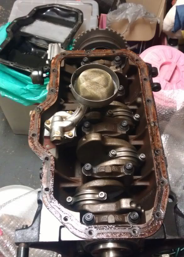

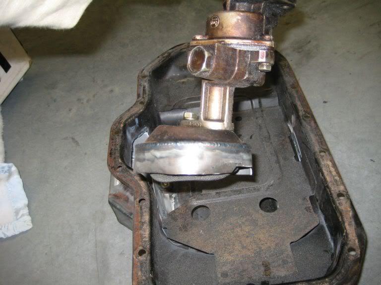

... and SHROUD the oil pickup!!!
The biggest thing that was highlighted as an issue is the oil pickup is potentially prone to cavitation (pulling air into the pump), hence shrouding it will help immensely.
Below i've shown the two setups that were done for me.
One was originally done for the midsump, when i had the RA28.
Then i sold that, got a KE70, and switched to front sump.
Note the extra shrouding added around the pickup.
Mid sump..... with winged/baffled sump
Front sump pickup
JMR actually suggested that a reversed funnel/cone type of shroud would be even better again to avoid sucking air with the oil.
