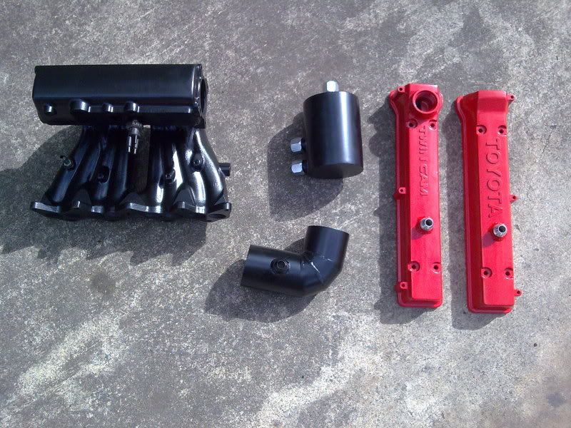

    that intake manifold was made by Craig @ Extreme Custom Engineering in Archerfield, QLD. He does excellent fabrication work.
    4,565
    Default Re: Keeping my underbonnet temps down. plenty of Qs.
    No doubt he does do good work, just that manifold would produce almost no power gains over the factory item.
    MWP - Edited to not annoy you...

    4,565
    I dont get it... why are you defending him and showing off an unrelated manifold (with super huge annoying photos too)??
    Do you work for the guy or something?
    This is getting waaaay off topic.
    I wasnt saying his fab work or welding wasnt any good.
    I was saying that using the factory 8 runner TVIS bottom half is not a good idea.
    Its like the "polishing a turd" statement... whats the point of going to all that trouble (new plenum, port & polish, etc), if your doing to use the factory runners which are no good for high end performance?
    Heat wrap is the devil. Have seen a LOT of well-made headers crack within 6 months-1 year due to them being wrapped. Step 1 is to ceramic coat, step 2 is to insulate things that might get hot elsewhere (ie. heater hoses, etc). The ACL stuff is great, I'd use it to shield your turbo and exhaust.
    Don't forget you can ceramic coat a lot of things - fuel rails, plenums, intake piping, rocker covers, etc. Most of the time it's cheaper than powder coating and won't ever come off, plus looks good + stops rust.
    All of that cost me around the $250 mark including having everything stripped/soaked in carb-sol, sand blasted, rust-proofed (steel only obviously) and then heat + colour coated.
